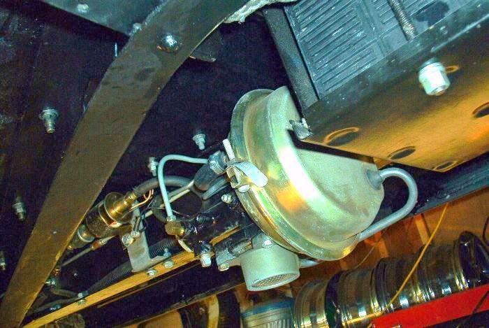

After 80+ years I am surprised that mechanical brakes still have a following. I guess I understand their continuance on 100% restorations but for driving in today's world, no way.
I have '46-'48 hardware on my '35 and they work and look factory. I did add a vacuum booster (no holes to drill just used original frame holes). It brakes as good as my daily drivers. When my foot tells my '35 to stop, it stops!
