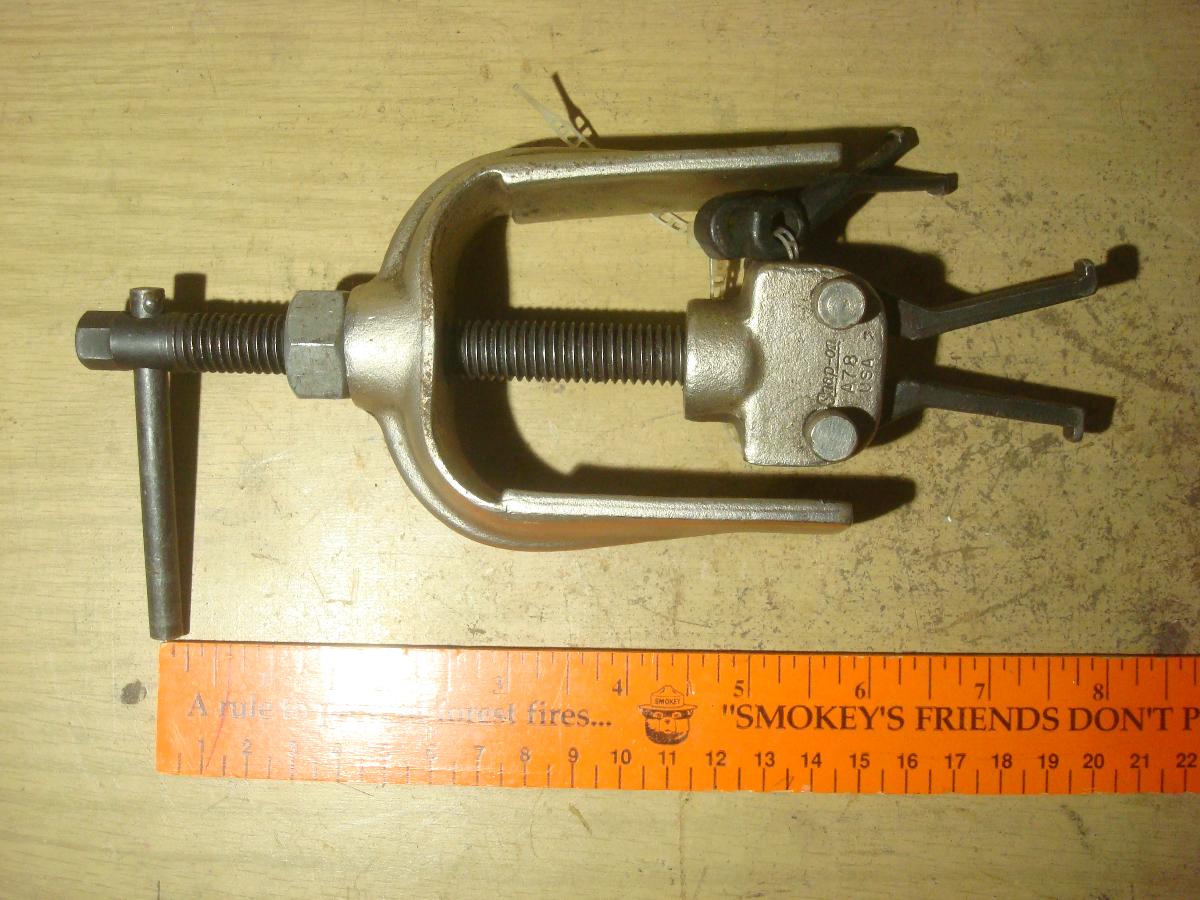

37RAGTOPMAN - if you have a pilot bearing puller could you post a photo of it on this topic thread.
Thanks
05-28-2021 @ 4:34 PM
hi

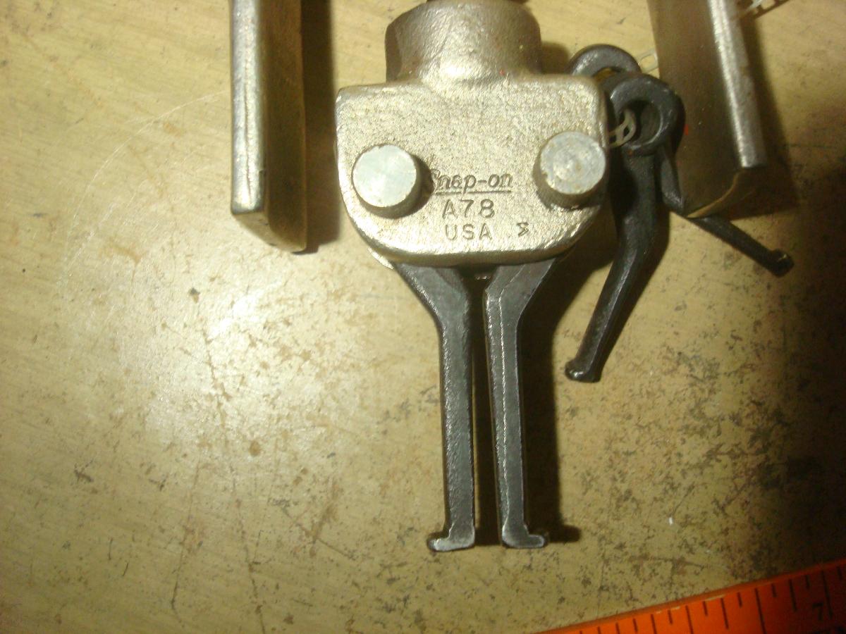

here is the SNAP=ON A 78 PILOT BEARING PULLER. with 2 sets of jaws
hope this helps 37Ragtopman, Maine

Thank you 37 RAGTOPMAN - I'll see if I can find one
