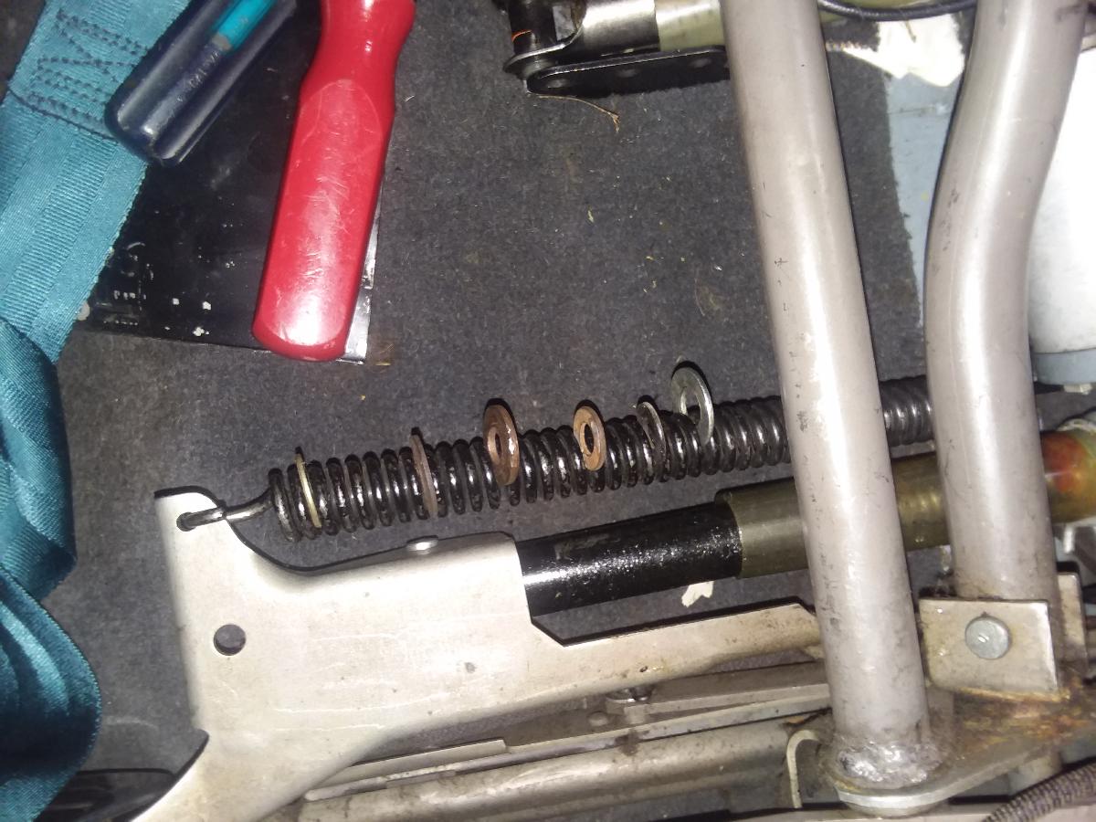

To install the springs, I clamp one end in a vise and bend the spring so I can insert washers between the coils. Then I install the spring and operate the support to remove the washers.
Here is a photo that I took when installing new spring on the power seat of my Lincoln

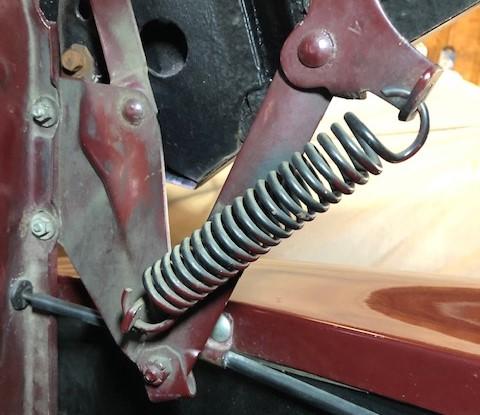

Here is a pic of one of the hood springs on my '46 Coupe. As you see, both ends are hooked in the same direction. Don't worry about the spring falling off, because they never go out of tension once installed. I watched my spring travel today, and noted that there is the least tension when the hood is in the full up position. The layout of the hinge pulls the spring longer as the hood gets closer to closed. Tom's suggestion with the washers is a good one, and I have used that for other applications, and it works.

Thanks for the pics. Woodie's pic shows what my old spring looks like. The new spring has one hook 180 degrees opposed to the other. Will it still work? Yeah I noticed that the spring has more tension as the hood closes and thanks for the washer idea. My son has a hook type tool that came with his trampoline that he had to use to assemble the springs to the unit. I'll try both things if you think the spring will work with opposed hooks.

Since last post I bought 2 hood arm springs from Carpenters and have tried to install one to replace the broken one. Here's the problem. The spring they sell now does not look like the picture that woodie posted which is what I need. The springs I got have the ends 180 degrees opposed to each other. The pics show the two open ends facing each other.
I called Carpenters and was told they don't make the spring like the picture in their catalog or on line anymore, but the spring like they sold me. I then checked the Drake catalog and it has the same picture. I will contact them today to check if they really have the pictured spring. I know the two companies supply each other so we'll see.
My son helped me try to put the spring on last night and the hood arm started to bend. Yes, he's very strong. Now I'm concerned that IF I can get the spring mounted, will the arms bend when I close the hood? Oh, ends that are 180 degrees opposed also have a different bend coming from the coil portion to the beginning of the hook. I hope this is fairly clear to everyone. My questions are, does anyone have experience in installing this type of spring? Does anyone know of another source where I might order the correct spring? Or does anyone have one they don't need?

Thanks, Paul. As I said earlier I was calling Drakes today. Just got off the phone with them. Initially I was told that they didn't have them anymore, but one of the guys went to the warehouse and found some. The hooks are just like Woodie posted earlier. I ordered one which is $10.00 with $14.00 for shipping. Should have it Monday. When I get it and check it out, I'll let ya'll know if it is the right one. If so, at least we know we can still get them, if anyone needs one.
