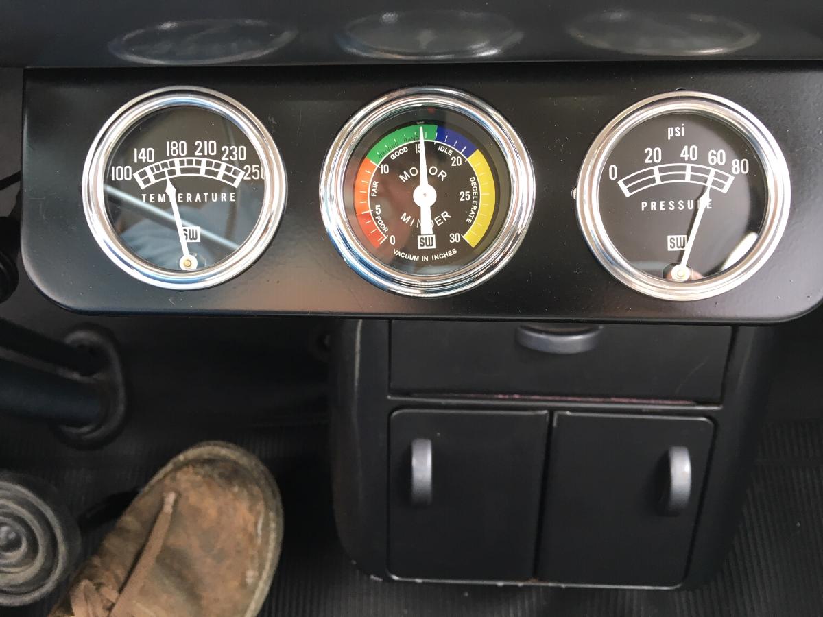

I live in Texas where heat is just something we live with. My approach to conquering a tendency for my '40 to run hotter than I like was to remove the thermostats and run straight water with Water Wetter to handle corrosion issues and help water with better heat transfer. The car runs and idles beautifully and only has a tendency to creep up in temperature when allowed to idle excessively. That can be due partly to a problem every '40 & '41 owner has...a crank-mounted fan. I have an analog temp gauge under the dash to monitor coolant temp, and it never exceeds 185 degrees. I'm aware that Ford supplied the Flathead with thermostats and had good reasons for doing so, but this combination works well for me.
