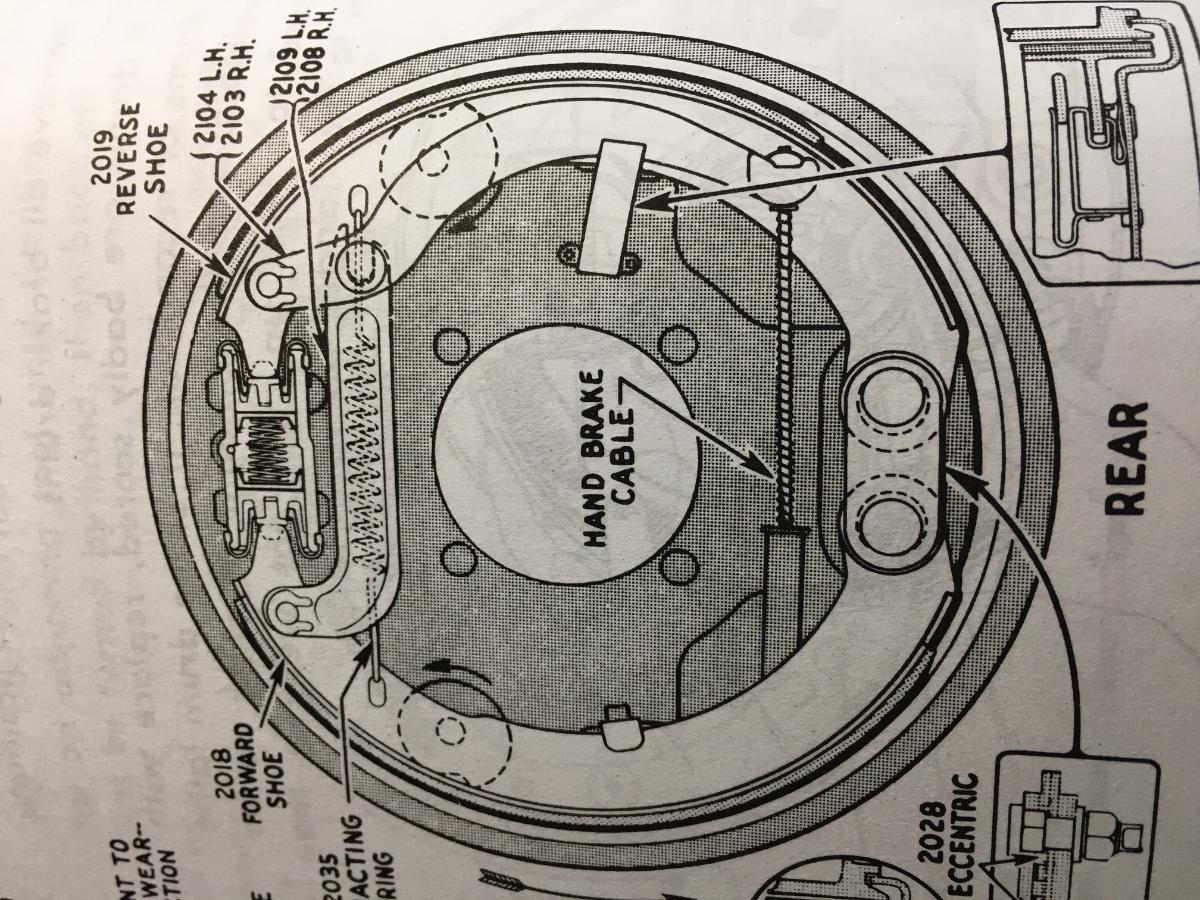

Looking to replace the rear emergency cable on my 46 coupe. Both Mac and C&G say "Requires shortening the spring." Before I order, will somebody please tell me.....exactly what does that entail, a real headache or a five minute fix? The reason I'm replacing the one on there is..... it was too long when installed. It has a little shortening device on both cables and I think they have reached maximum usage. Appreciate all input.

The spring that goes against the brake lever is too long on the repop cables. Takes just a few minutes to shorten it.

The two springs that are inside the brake drum are too long. If you have a Dremmel tool with a cut off wheel it's a 10 minute job to shorten and then cut the excess amount off the cable. Maybe someone has the proper length needed.

silverchief. I had that problem with my '46 Coupe as well. The spring that goes over the handbrake cable, between the cable tube and the brake actuating lever is too long. The spring becomes coil bound before the lever travels far enough to fully apply the brakes. I can't remember how much I cut off, but I think it was about a 1/2".
