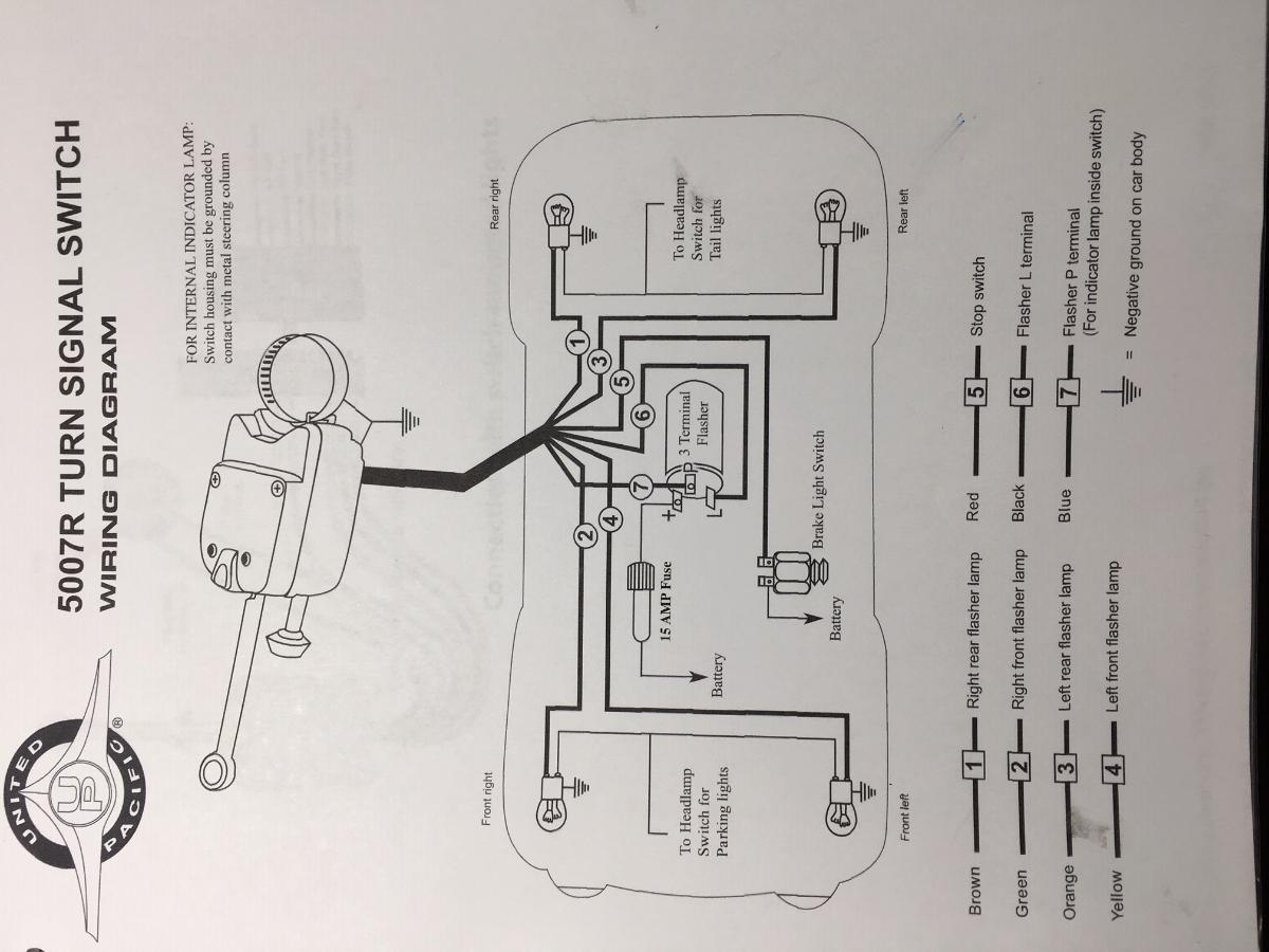

I have a 52 Ford. Trying to re-wire blinkers. Anyone know of an easy wiring diagram to help a novice?

This diagram should help you.

I think he would need the color codes of the wires in your diagram to use it; wouldn't he?? I had one of that specific turn signal switch, and the wires are alll sorts of diferent colors.You can do it without the colors, but it is not as easy..

Tyeree wires sell a wiring harness with instructions for turn signals on your 52 Ford. It would be much easire and cost effective to buy the harness from him.

Page 7-17 & 7-18 of the Club's 1952-1953 restoration book illustrates the wiring including the color codes and the connections.
