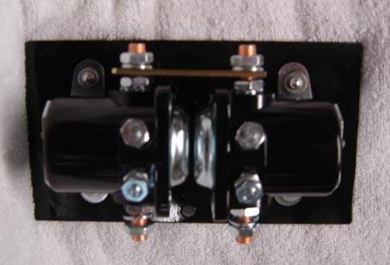

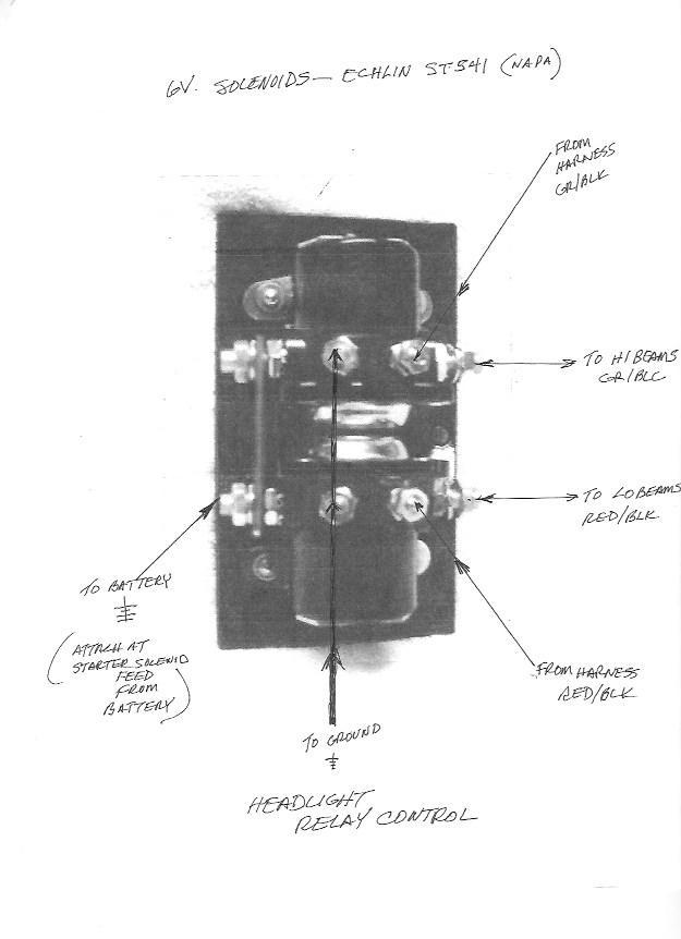

Usually the problem with dim headlights is that most of the power is lost at the dash switch, the dimmer switch, and the numerous "bullet" connectors. I solved the problem in my '47 by operating the lights though a pair of 6v starter solenoids controlled by the stock headlight wiring. Now the headlights are as bright as modern vehicles. If you need instructions, I can post them, or use the personal message to have it mailed.

Supereal, please post your instruction to this forum. Others on this site may find your information useful.

I second that motion, Supereal. If you could post those instructions, that would be a big help.
Where did you install the extra solenoids on your '47? On one of the inner fenders?
Are you using a normal six volt headlamp bulb like a Wagner 6006?
