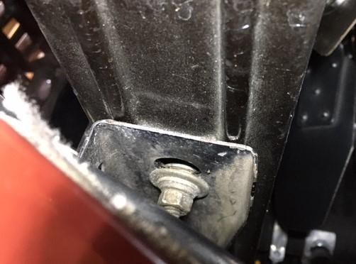

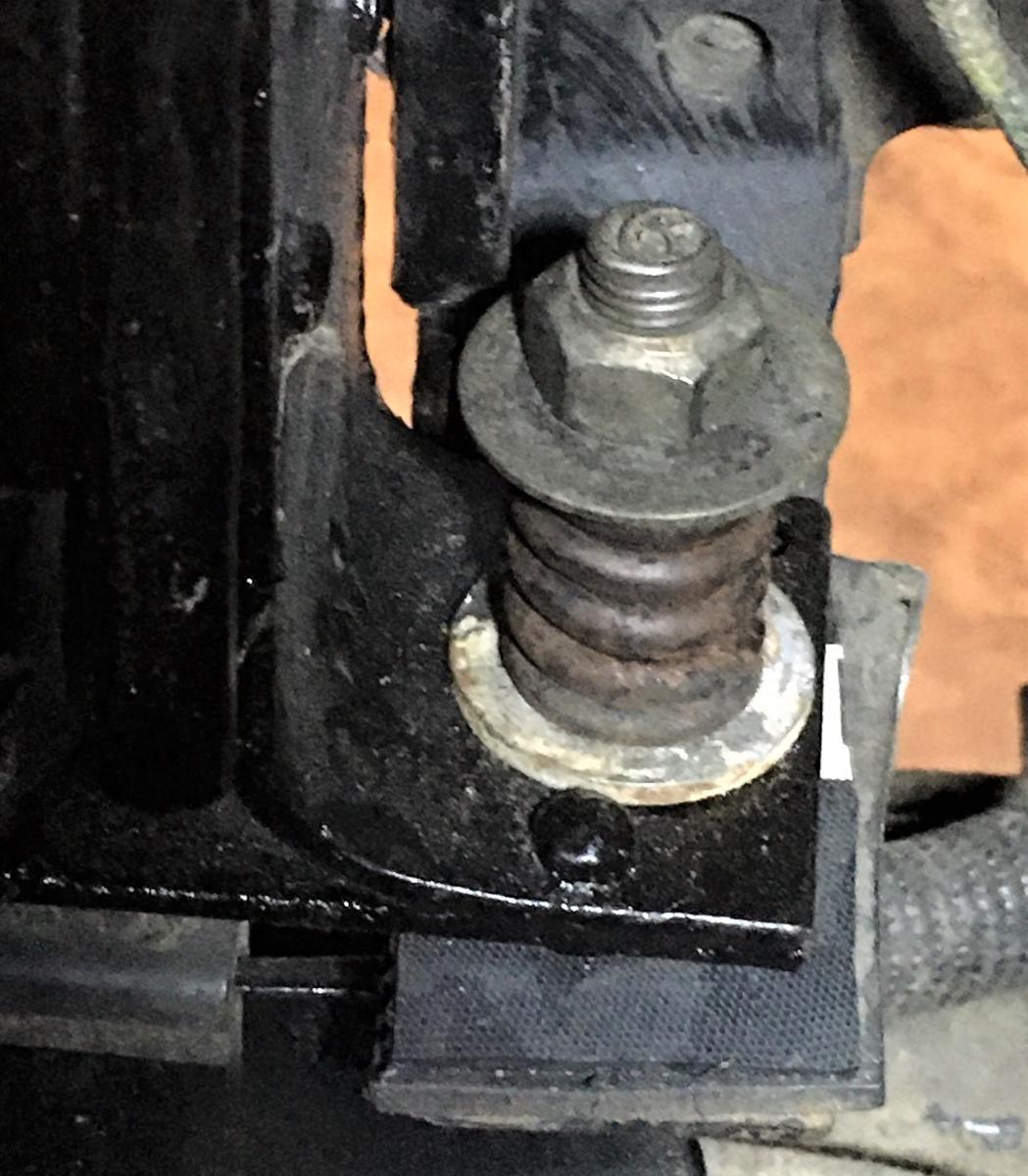

The rad has an "ear" on both sides at the bottom of the rad frame, and a keyhole slot on each side, about a 1/4 way down from the top of the frame. On my 46 Coupe, there is a thin rubber pad that goes on the frame and the ears sit on them. One picture shows the arrangement for the bolt/spring/nut assembly for the bottom mount, and the other shows the top mount bolts. The top bolts are like a carriage head bolt. The head of the bolt fits through the keyhole slot in the rad support frame, and into the keyhole slot in the rad frame, then slide the bolt down, to lock it into the read frame. The bottom bolt comes up from the bottom, a flat washer, the spring, a flat washer and the nut. I used "Stover" locking nuts, so they couldn't back off. Don't over compress the springs when tightening the nut, there needs to be spacing between the coils. The bolts/ nuts I used would lose you points if the car was being judged, but they hold the rad in.

Something minor to note. The bolt that is pictured should be a bolt with a castle nut and a cotter pin. The combination of vibration and the spring pushing against the nut can cause it to become loose.

Not a castile nut but rather, a slotted head hex nut. They are not the same.
