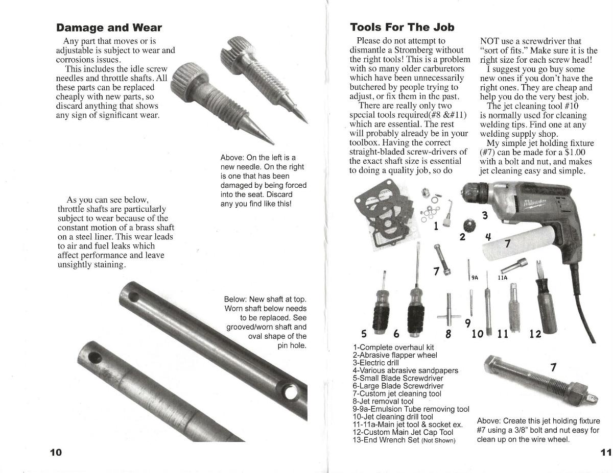

I have purchased Vern Tardel's Stromberg 97 help book. Please see the attached photo. I am interested in Tool # 11 and Tool # 11a. Tool # 11 -- What is tool #11 ? Where can I get one? What is it called? Tool # 11a -- Is this an ordinary socket extension? If so, what size? Or is it a special extension? Tool # 12 -- What size screwdriver? What are the dimensions of the modification? Vern says that tool number 11 is "essential". I wish he could have provided a little more detail. I went to the Stromberg page and that tool is not offered. Any help with tool number 11 and 11a and 12 greatly appreciated.

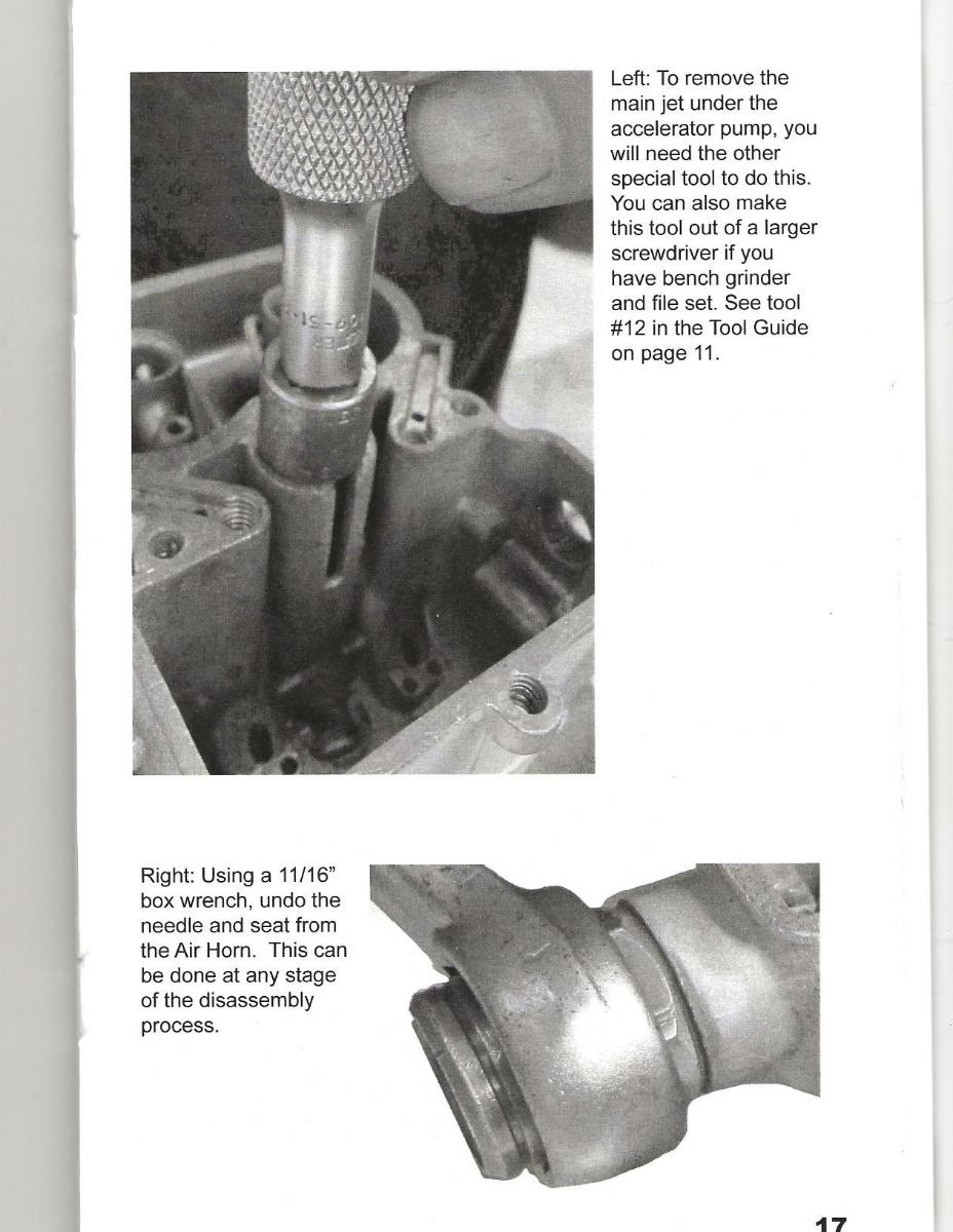

Here is a photo of Vern using Tool #11 and Tool #11a in combination.
