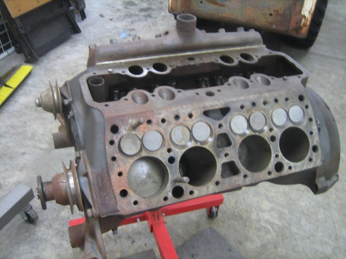

40 Coupe |
03-25-2021 @ 5:18 AM
Posts: 1801
for 1941 the block is different than the 81A . The 81A was used from 38 to 40 it has a flat surface under the intake manifold. The 41 block has a raised surface under the intake manifold. The 81A block is shown below.
