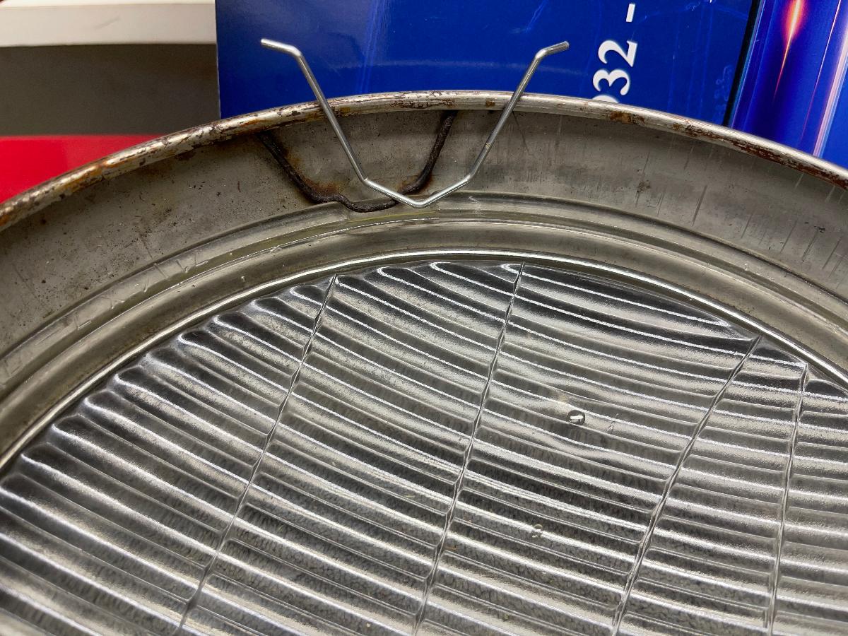

As the photo shows from the left headlight on my 35 Ford, the 34 clips fit perfectly while the 35-36 clips are too big. To install the larger clip I would have to severely bend both arms down.

Okay problem solved. For anyone else as perplexed as I was, to install the 35-36 clips on a 35 Ford, you just bend the two arms of the clip down severely.

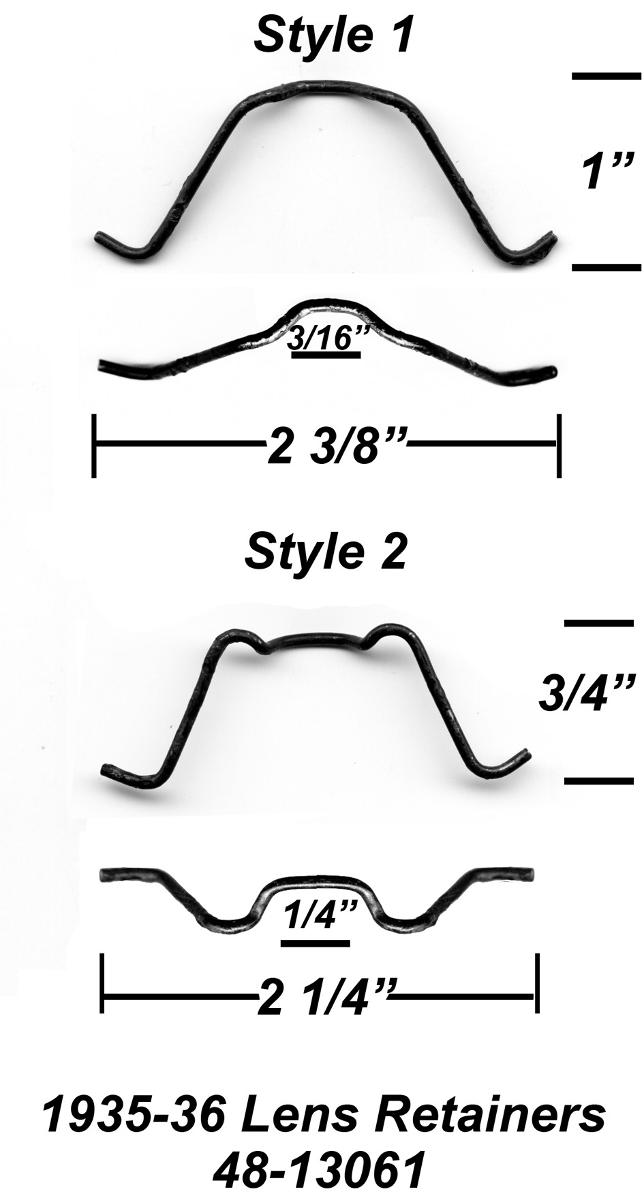

Please let me clarify!!! Your photo shows a 35-36 clip (48-13061) installed properly!! I don't know what that other large clip is. It isn't 35 or 36. Here is a photo showing the 2 styles of 48-18061 clips that I have found over the past 45 years. Style 1 is probably an early repop.

Don,
That light-colored one in the photo is a recipe for chipping the edge of the lens; absolute repro junk.
