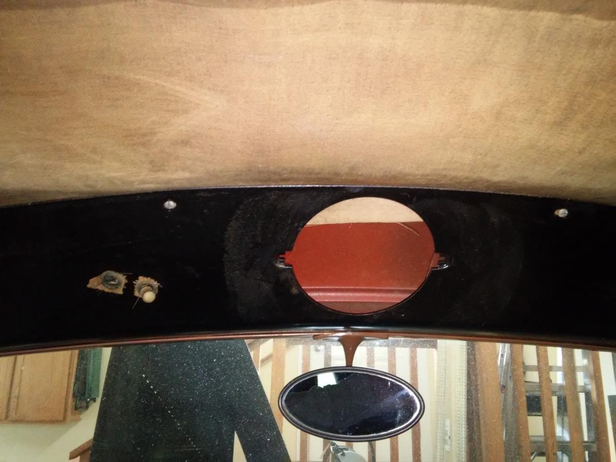

Before I begin removing the upper panel how much of the inner windshield surround do I need to remove? The drivers and passenger only before the upper panel?
Restoration in process to install an electric motor. Also open to suggestions on where to install a hot wire close to the resister/fuse. I'll install an on/off switch on the dash.
The picture shows the radio speaker opening and rear view mirror.

I still use vccume wiper on my 34's. The vacume line runs up the inside of the drivers side windshield post on my 34's, I assume that is the path to take for your wire. On all the early Ford V8's the radio speaker was under the dash above the steering column. Good luck.

1934 Ford is mistaken about the location of original EFV8 radio speakers.
In '35-36-37 the common location for the Ford Philco speaker in a closed car is in the overhead, early cars had a housing that bolted on the outside of the header panel. In late '35 and the majority of 1936 the speakers were concealed behind the panel, covered with upholstery.
Why do you want an electric wiper? A good vacuum wiper will work just as well and you can retain the stock wiper arm.
In order to get at the wiper motor, you will have to remove the entire header panel...
My '36 has dual wipers, running off of a single motor on the left side with an external slave shaft operating the right wiper which makes the wiper work in unison.
