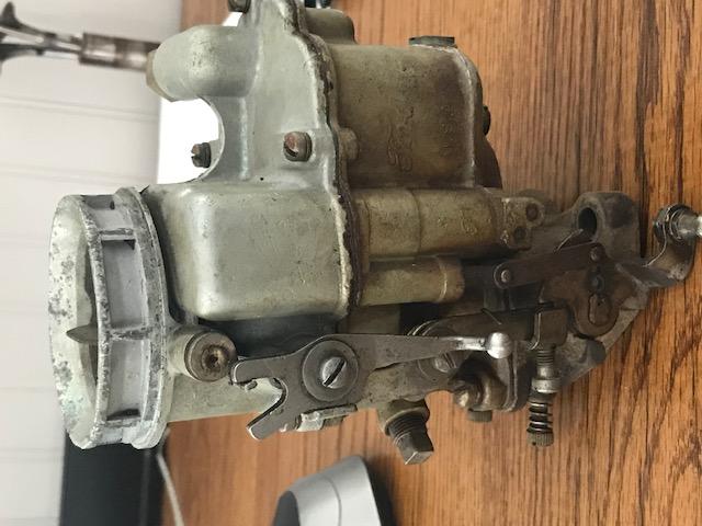

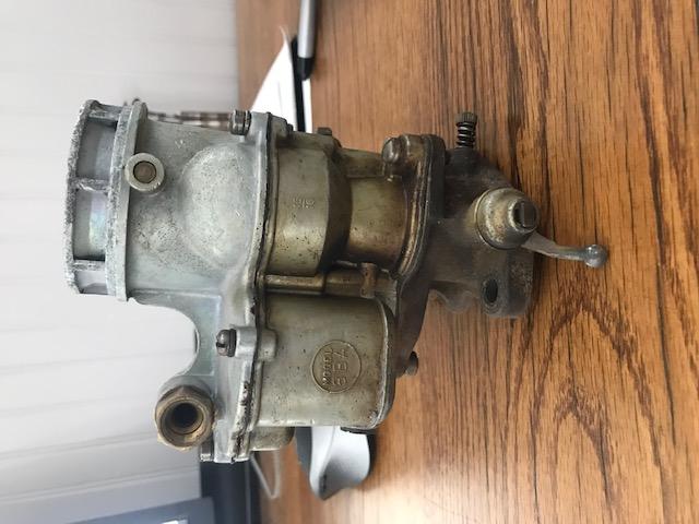

Thank you everyone for your advice. I did replace the carb with the spare one that I ha. The engine started right up!!
I will send the older carb to be rebuilt by Charlie.

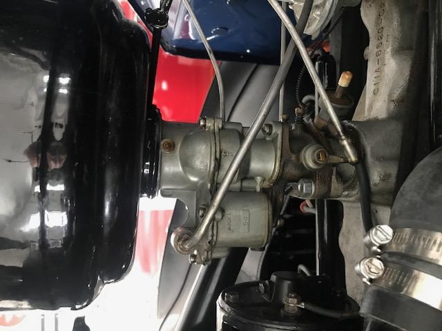

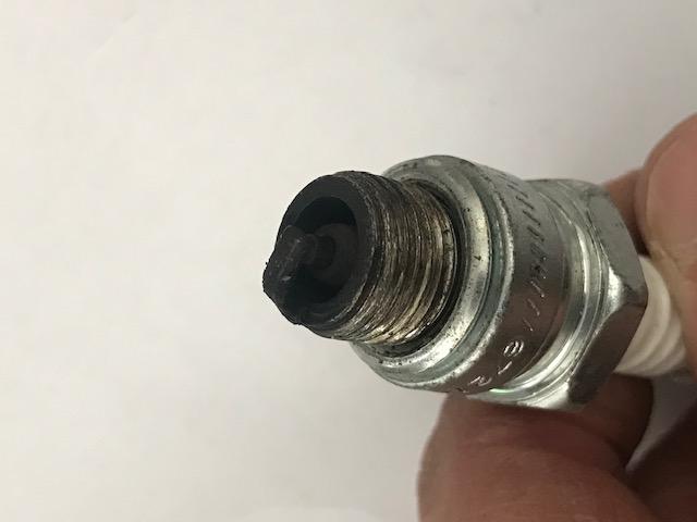

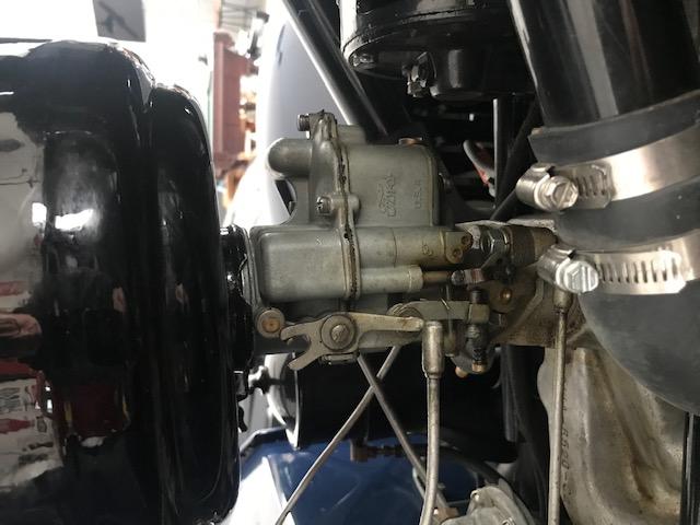

It looks like you have a 24 stud engine (1939-1948) in your car and a model 59 carburetor. The spark plug shows a very rich condition and you probably should have the carburetor rebuilt by someone who has lots of experience with these carburetors like Charlie Schwendler in NY. He does a good job and machines the power valve seat so that it doesn't leak. All of his carburetors are engine tested before shipping.

Your spare carburetor is for the 49-51 engines and it looks like it had a leaking problem also.

I think that I agree with you. It may be the Carb. I am getting a strong spark. It is the original coil. I removed a plug. It seems to be burning rich. (see photos) I do have another carb that I had from my previous 36. I may try switching the carbs.

The lack of fuel condition occurs most often after the car has sat for a few days or longer. It can be caused by a leaking carburetor. You would have to identify the carburetor model in order to check this out as the Stromberg carburetor has different causes than the Holley / Ford carburetor. Please post photos of the left and right sides of your carburetor. This will help in diagnosing your starting problems.
