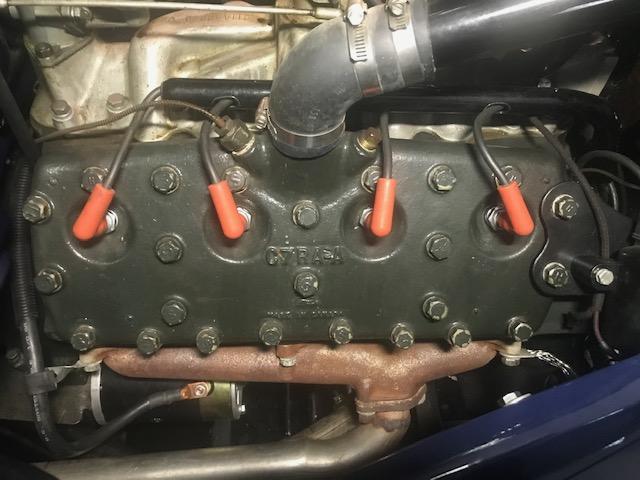

Hello, I bought this 36 Ford 2 years ago. I'm trying to ID the engine. It is a Canadian car with a later model 24 stud head engine. Is this equivalent to the 8AB engine?

This is not an 8AB engine. This is a Second Generation Engine manufactured sometime between 1938 and 1948 for cars and up until 1947 for trucks. The 8AB Engine is a Third Generation Engine that was introduced in 1948 for trucks and 1949 for passenger cars.

The engine in your car is most likely an everyday generic late '30's, early '40's 221/239 CID 85 HP engine.
You did not receive any info on the engine conversion when you bought the car? I find that to be strange, of course if a dealer had the car they would not fool around with the history of the engine, especially since the engine is the correct color for a '36.
