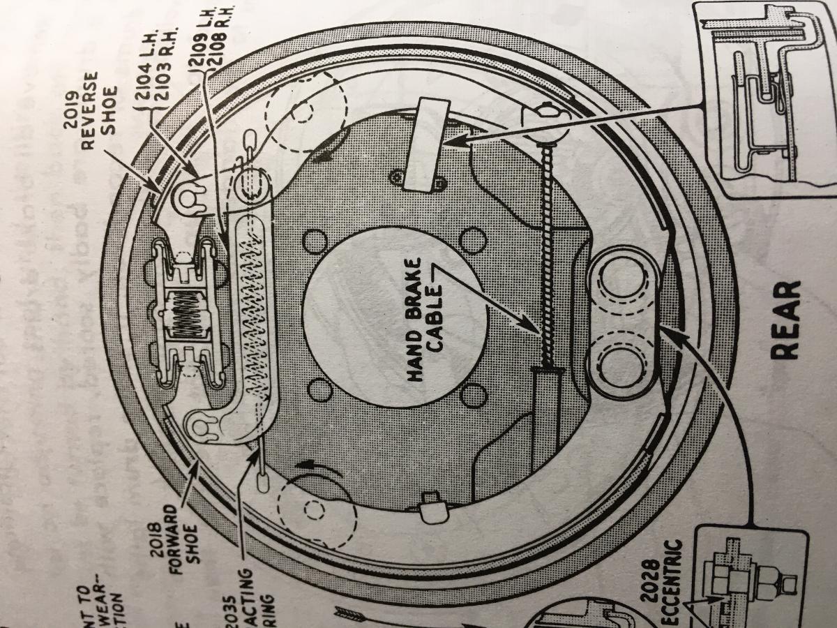

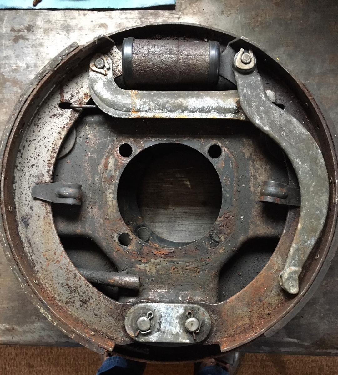

In installing a new rear brake cable on my 46 ,what is involved in attaching the cable at the rear wheels? Seems I recall you have to do some disassembly at the wheel. Thank you.
alanwoodieman |
02-09-2021 @ 3:40 PM
Posts: 873
you have to remove the rear hubs, which is a project in itself, then you connect the cable to the actuators
51woodie |
02-09-2021 @ 6:20 PM
If your rear drums are on the outside of the hub, you may just need to remove the drum to get access to connect the cables. The cable and spring enters the tube that is attached to the backing plate. The cable end hooks into the brake actuating arm, the spring is pushed (compressed) up against the actuating arm, enough to install a retaining clip over the cable between the end of the spring and the tube. The clip prevents the spring from goin back out the tube. There should also be a rubber "sleeve" that fits over the outside end of the tube, to prevent/dirt/water from getting into the brakes. If your drums don't come off the hub, then as Alan noted, that is a bigger job that requires a hub puller and big torque wrench.
