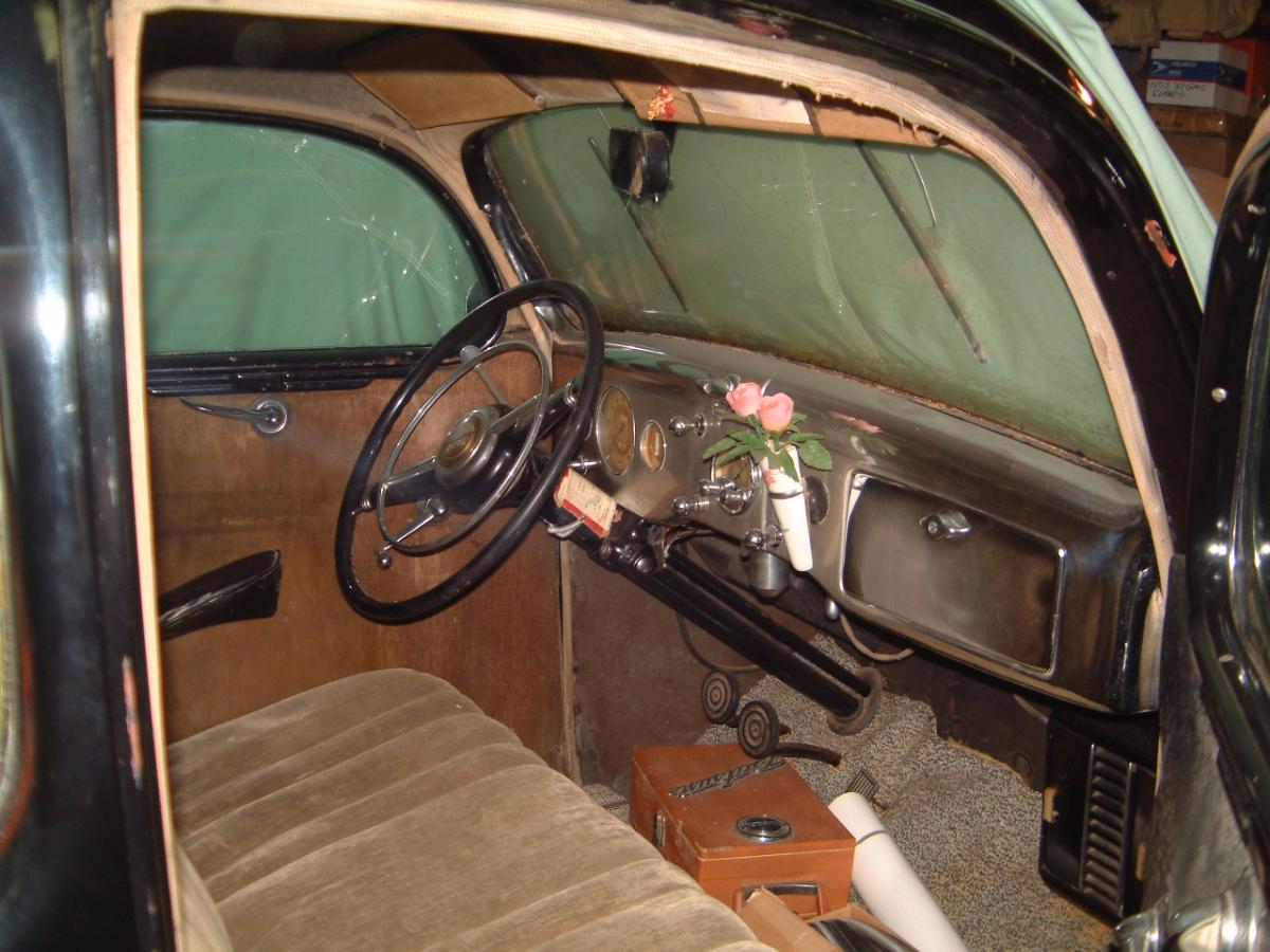

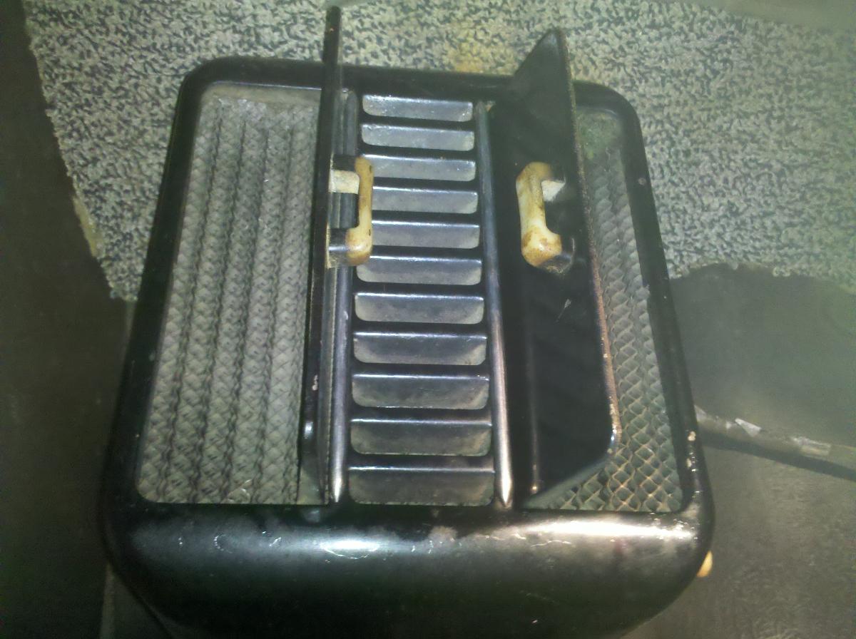

Most people want to install the hot water heater in the center of the firewall, over the gear shift stick, mine is installed on the passenger side of the firewall, lots of foot room... See attached pix.
A 180 degree thermostat is a must have item, actually the 180 stat is good year round.

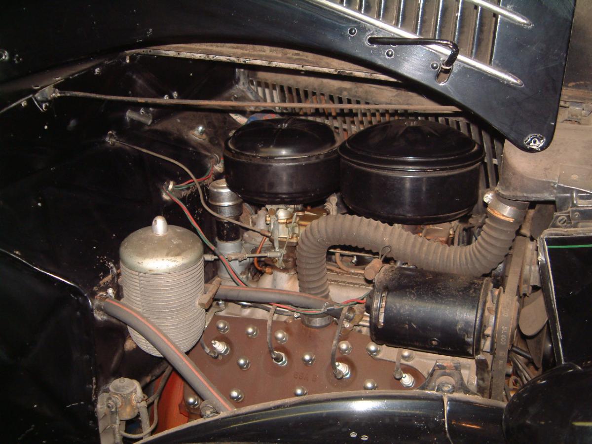

Pix #3 shows the hose routing which does not get all tangled up with the fuel pump and throttle linkage.

For some unknown reason the third pix did not load, this pix shows the hose routing for the passenger side of the cowl.
Bill
