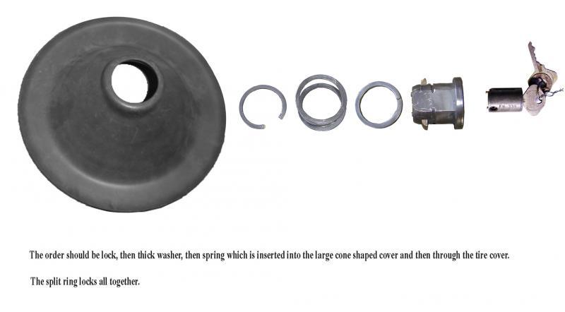

Any have a drawing or photo of how the spare tire lock assy is put together?

G Tosel |
02-08-2021 @ 11:54 AM
Posts: 95
36 Ford spare tire lock system photo.

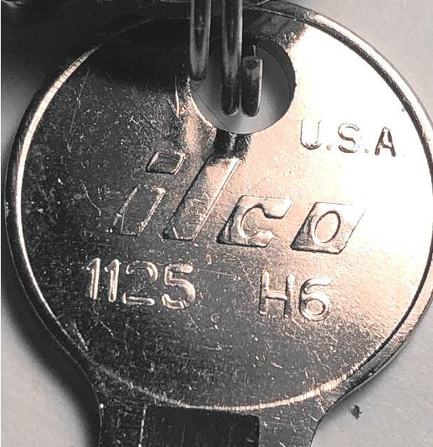

Steve Kennedy |
02-09-2021 @ 4:50 AM
Posts: 64
Joined: Jul 2017
My mistake, the ILCO 1125 H6 key fits the gas cap, not the spare tire lock
