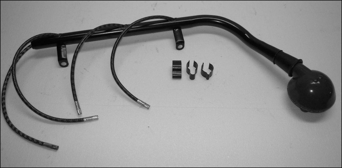

The ones you want are longer where they "drop down" to the distributor than the later (42 -48). There are other differences as well. Picture attached is what you are looking for. I may have some perfect ones. I could look if you like.

I suspect the ones for the "crab" style distributor cap are different from the others. At least the ones for the 42 are different as they have holes on both sides as one of the left side wires crosses over to the right cylinder bank and one of the right side wires crosses over to the left bank.
