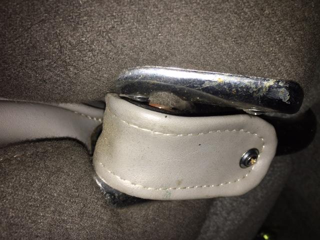

I have a 48 Ford coupe that is missing a small piece of material between front seat back cushions to cover the seat frame at the pivots, I don't know if this something Ford did or restorers did on their own. I have seen it on other Fords, if anyone has such a piece a sketch with dims or a template would help. Thanks for any information you can offer

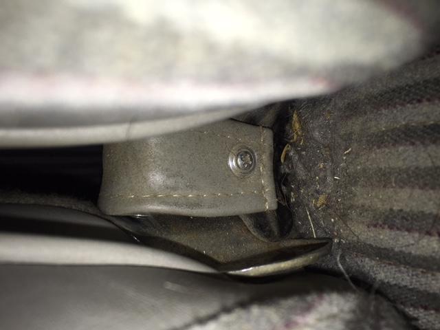

leazer. Here is what I have on my '46 Super Deluxe Coupe. I looked in the 1941-48 EFV8 book, but didn't see any note on that item. My car was kept original, but has gone through several owners, so I don't know if the material used on the cover is original or the original type. I hope the pictures help. I hate it when the pics get turned out of orientation. In this case, sideways.

leazer 48 |
01-19-2021 @ 11:45 AM
Posts: 17
Joined: Mar 2020
thanks for the photos, I now have some idea what it looks like and will try to make a template for a upholstery shop to make

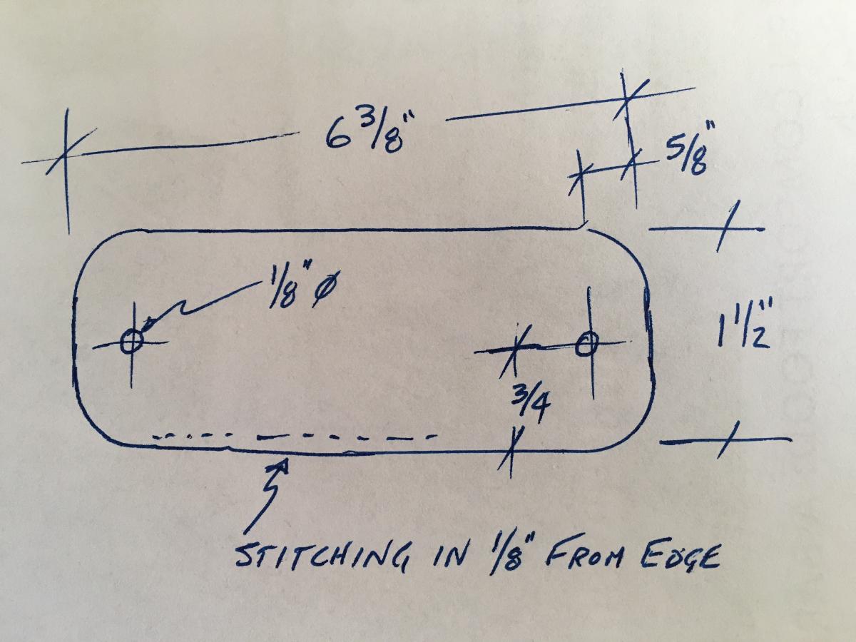

leazer 48 |
01-19-2021 @ 12:27 PM
Posts: 17
Joined: Mar 2020
The photos are great, would it be possible for you to make a sketch of that piece from your car, if that's to much trouble I understand but I had to ask. thanks again
51woodie |
01-19-2021 @ 1:10 PM
I can, but it will be a few days from now.

leazer, The center piece in the photo is correct. I have a Lebaron-Bonney kit in my '48 with the gray cloth material. The center cover piece is made from a light gray vinyl material.

51woodie |
01-21-2021 @ 1:28 PM
leazer. Finally got time to go out and take measurements for you. I was happy that it warmed up to 20F. here in Northern Ontario, so my old hands didn't get too cold. I hope this sketch is clear enough.
leazer 48 |
01-25-2021 @ 4:31 PM
Posts: 17
Joined: Mar 2020
question for 51 Woody, in the photos you sent the photo of the front of the strap is tapered not rounded corners, is there reason for this or does it matter, just some clarification. thanks
