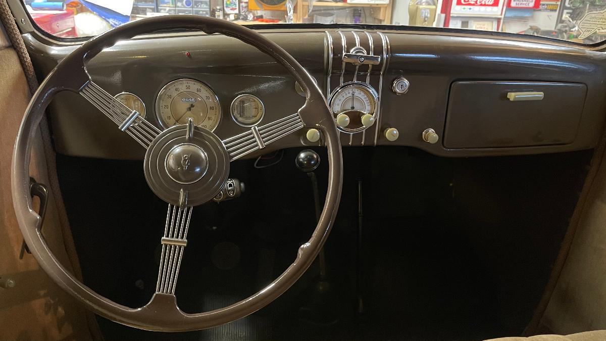

New look to finish out the dash.

Oh my I just figured out my problem as to why my replacement Banjo steering wheel was so loose. When I pulled off the original 35 standard wheel, I installed the 1936 Lincoln banjo wheel using the original steering wheel Key. I had already ordered a new key but decided to use the original one. Long story short, the new key is bigger. When I replaced the smaller key the banjo fit snug. This may help someone else. The remanufactured keys are bigger than the original keys.
