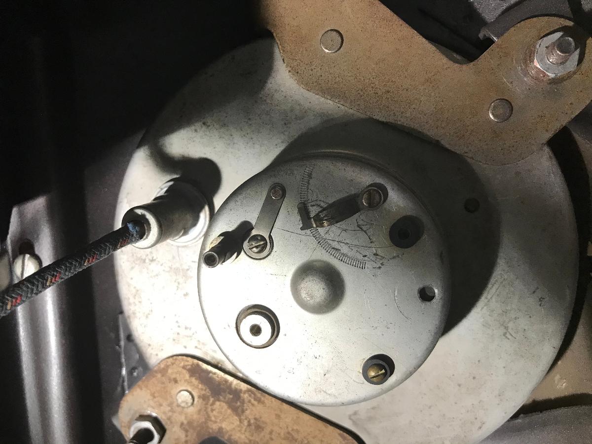

Below is a photo of the back of the clock and then the front. I am installing my new wiring harness and cannot figure what and where the connections go. The light socket is a no brainer. Where does the power hook up? Thanks in advance for the replies.

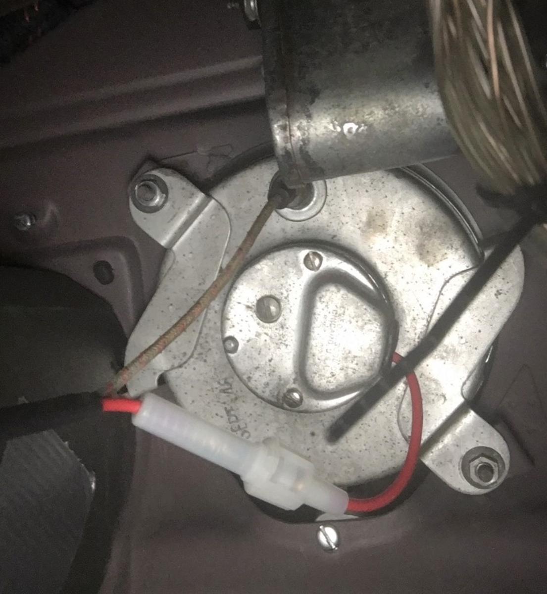

James. I thought I had the answer, but my '46 clock is different than your '47. Hard to tell from the picture, but is the "post" that sticks up next to the light socket a possible connection point for a bullet connector? can you take the small cover that has the speed adjustment off?

I think you are on to something. I found the cover last night and seeing your photo tells me I’m missing a couple more items. I’m going to remove the clock to further analyze. Thanks for the help.

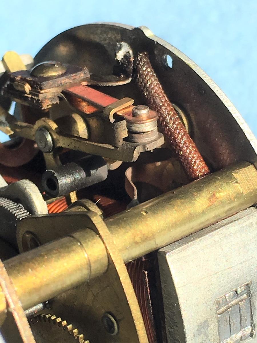

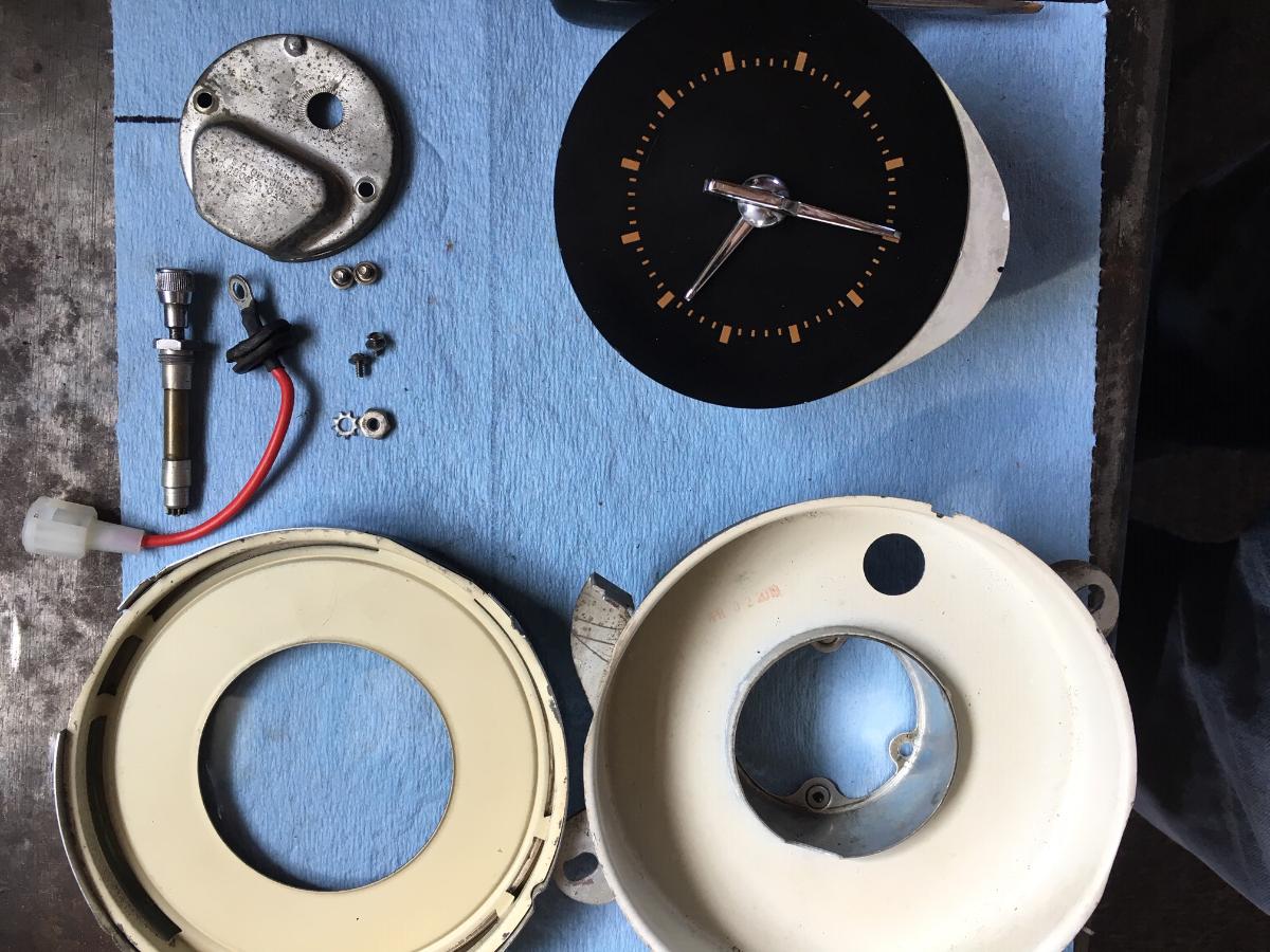

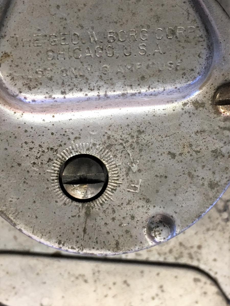

My clock was made by the Geo. W Borg Co. in Chicago. The stamping also says to use a 3A fuse. My clock quit working, and had no continuity when checked with an ohmmeter. So I took its apart, and found the contacts that energize the winding coil/solenoid were dirty, and not making contact. Cleaned them, put a bit of clock oil on what I figured were critical rotating parts, and it runs great. It took me a week having it on the bench connected to 6V to set the speed so it keeps reasonably good time. Of course I'm retired, so a minute here or there is no biggie. Just as long as the old ticker keeps ticking.

01-10-2021 @ 12:08 PM
Posts: 6819
