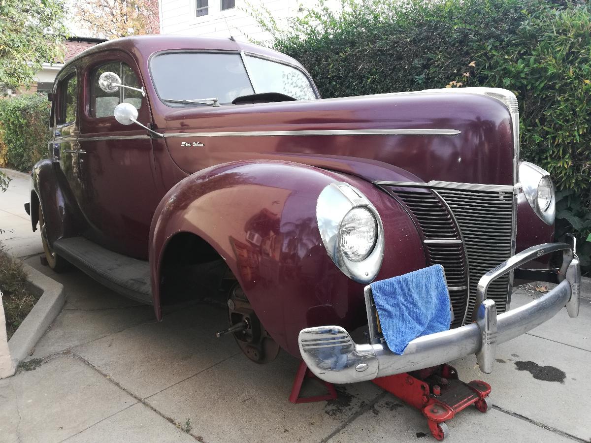

I have the drums and brakes off the front of the car right now. I am trying to figure out if I am brave enough to tackle the king pins on my 1940 Ford Sedan. There is definitely some slop in them. I am also going to look to see if there slop in the steering linkage. Are there any videos that show how to take the tie rod and drag link (I think I am using the right terms) off? If they are loose, can the existing ones be re-used but re-bushed? Sorry, I am showing my ignorance here. Any guidance would be greatly appreciated.
