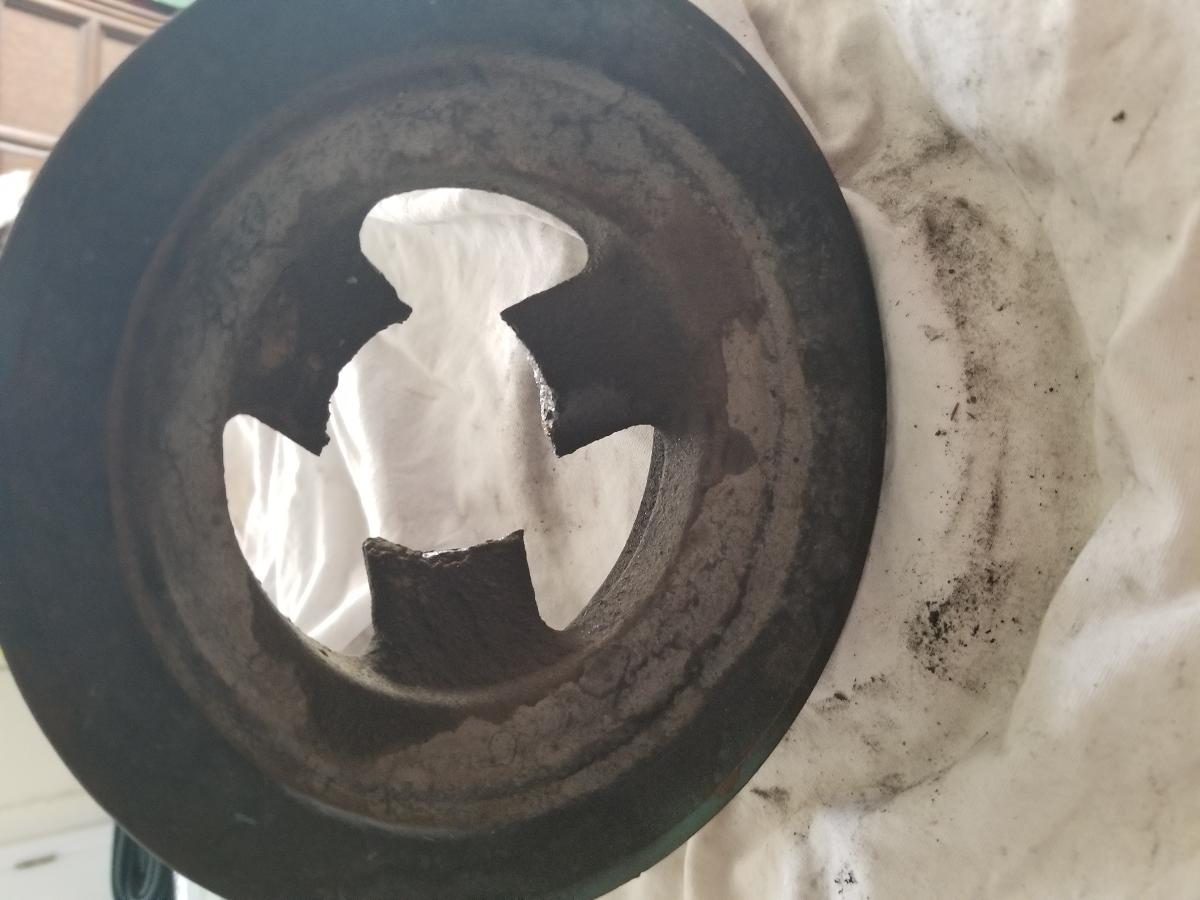

Hello everyone I recently got a 1953 ford customline with the 3.9l flathead v8 and the crankshaft pulley snapped while I was driving yesterday. I have been looking for a replacement and cannot seem to find one as my car has power steering and requires the three belt pulley not the two belt pulley. Any advice as to where I could locate the correct pulley would be much appreciated. Thanks

I don't have an answer for replacement but could an expert welder repair it?

Yeah I'm taking it to a welder tomorrow to see what they say. Just have to get the rest of the pulley off of the engine. Thanks

My 1953 Ford or 1953 Mercury parts catalogs do not have power steering parts listed. I am not sure if the 54 crankshaft pulley would fit your car, but there are 5 of B54A-6312-A on Rear Counter.
https://www.rearcounter.com/B4A-6312-A-parts1526589.html
There are reproductions available on E-Bay and that may be a better option than welding the cast iron. The iron is old and may break again if welded.
https://www.ebay.com/itm/383311759326

In the 1950's Ground Mole machine shop in Bad Axe, Michigan would weld broken cast iron gears from sickle bars and manure spreaders with a novel "eutectic" rod that had two melting point metals in an alloy. Heliarc in the 1960's was probably a better choice but who did something like that in 1960? Braze welding would alloy joining the broken pieces but in spite of the motto on a sign at an An Arbor Shop, "we weld anything but the 'break of day'", probably would be not strong enough and you really need to mount the object in a lathe face to retain symmetry and balance. The best thing would be to make a new one from billet. Paint it black and no one will be the wiser. Maybe sand or bead blast it to give an "as cast" appearance? I had a friend who had the front pulley on his Triumph TR-4 fail after a while with an add on Judson Supercharger. What did he do? I don't remember.

I have a good spare one of those, part # EAC6312A. I see there are aluminum repo's available for $575 which is pretty far out there. The one I have for sale has slight damage at the keyway entrance which is pretty typical of that thin casting area otherwise shows very little wear. What kind of value do you have in mind?
