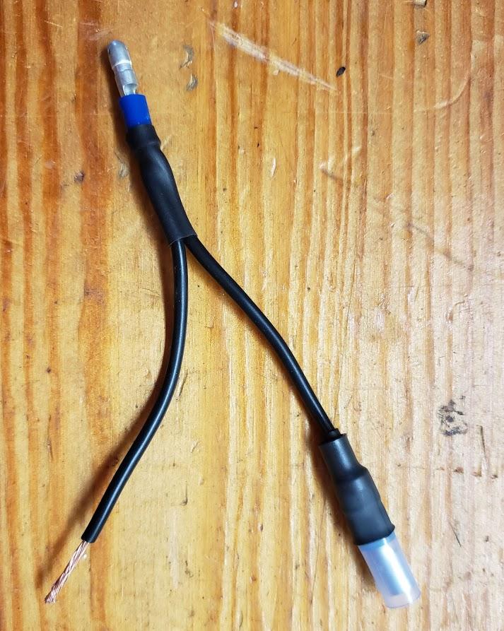

I installed my Brakelighter third brake light today, all I can say is WOW I feel so much safer when making a turn or stopping, its nice and bright, very visible. I don't like those crimp wire connectors that came with it ot cutting the harness so I made two little pig tails that work great.
