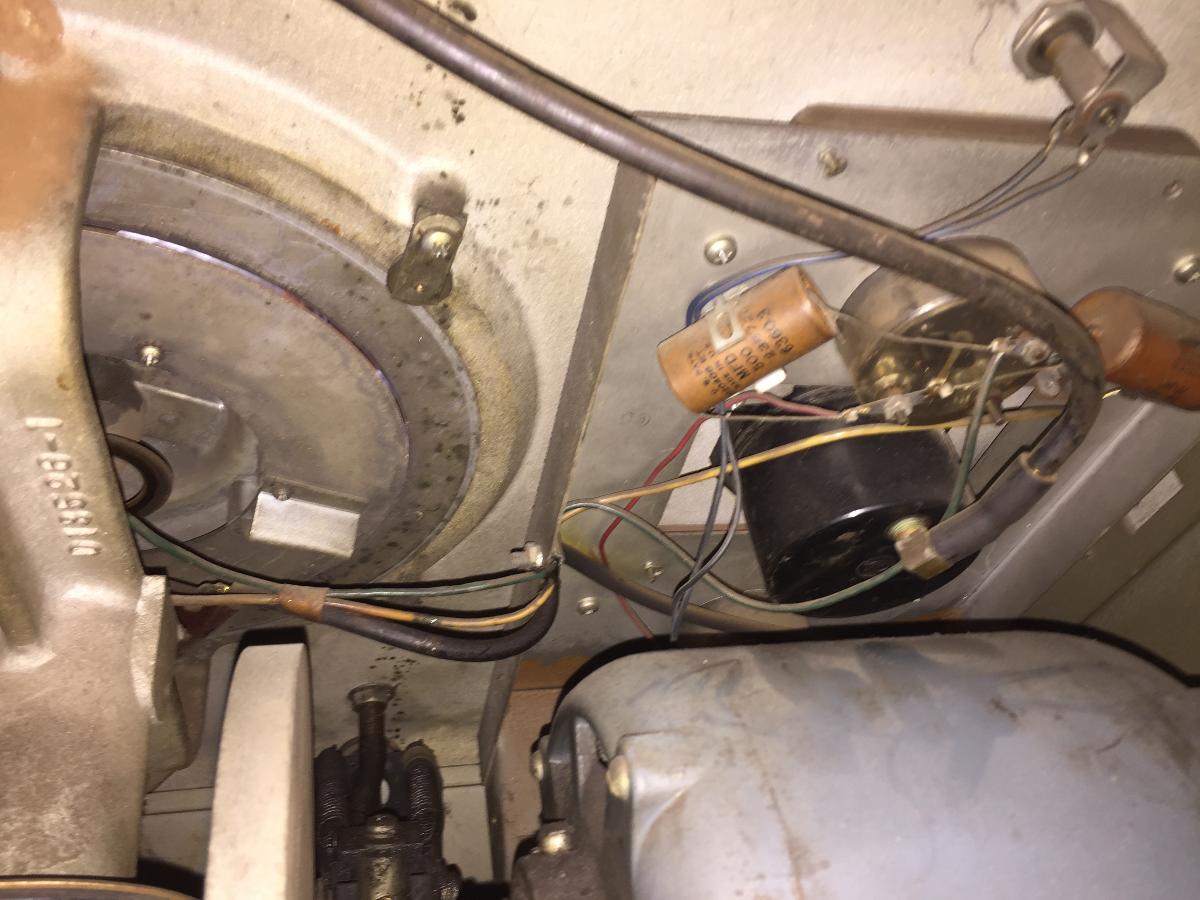

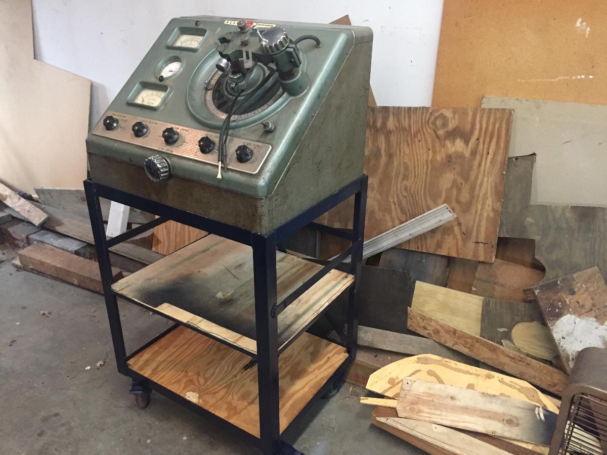

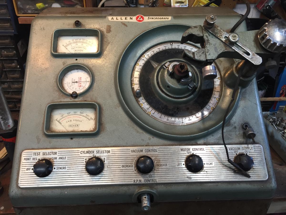

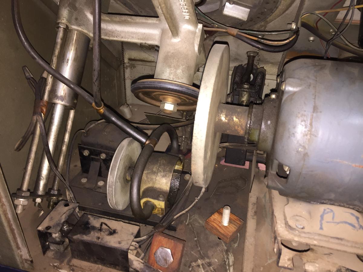

Here are some pictures of the Allen Syncrograph machine that I have. 2 pictures are of the internals with the 1.4 horse electric motor that runs the distributor shaft; and a good image of the vacuum pump. A strange contraption that used two opposing cylinders run by a shaft eccentric.
Look on Utube; there is a short video of one running a standard type distributor and several pictures. There may be some for sale on Ebay. I am still looking for the Ford adapter kit for the pre-1948 distributors
There are some Sun adapters that might work.
George.

George7, Thank you for posting those photos.
That is a great deal more sophisticated than the KR Wilson Fixture.
You machine is extremely impressive!
