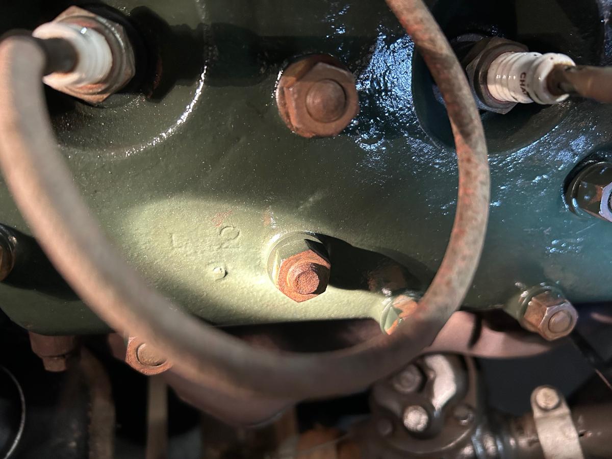

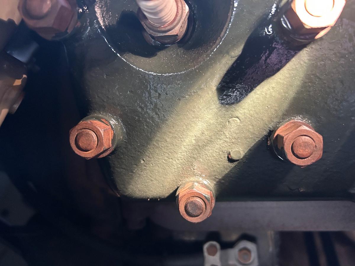

I have a 1935 fordor touring sedan, stock except for some parts off different years. I have iron heads, very little stamping or cast other than the Ford script center bottom and upper right is very light -B. 1. These were stock for 1935? My book says aluminum except for trucks and commercial cars. Just wanting to know more about my flat head. Thanks, Dennis
Kens 36 |
03-31-2025 @ 12:24 PM
Posts: 407
Dennis, Your sedan would have been equipped with aluminum heads from the factory. Lots of things can happen in 90 years. Someone probably replaced the aluminum heads with the commercial cast iron heads many years ago. Ken
