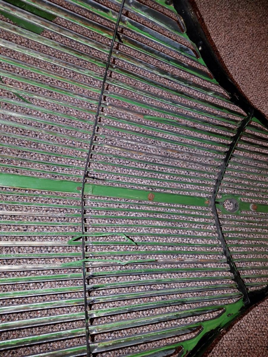

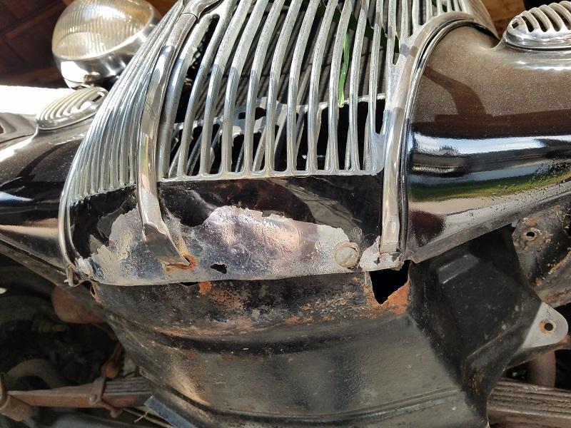

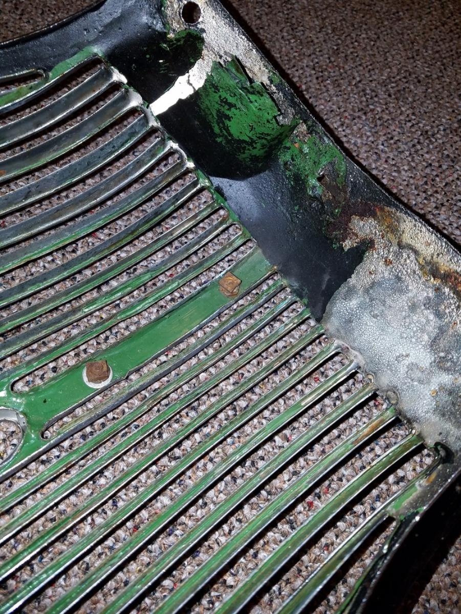

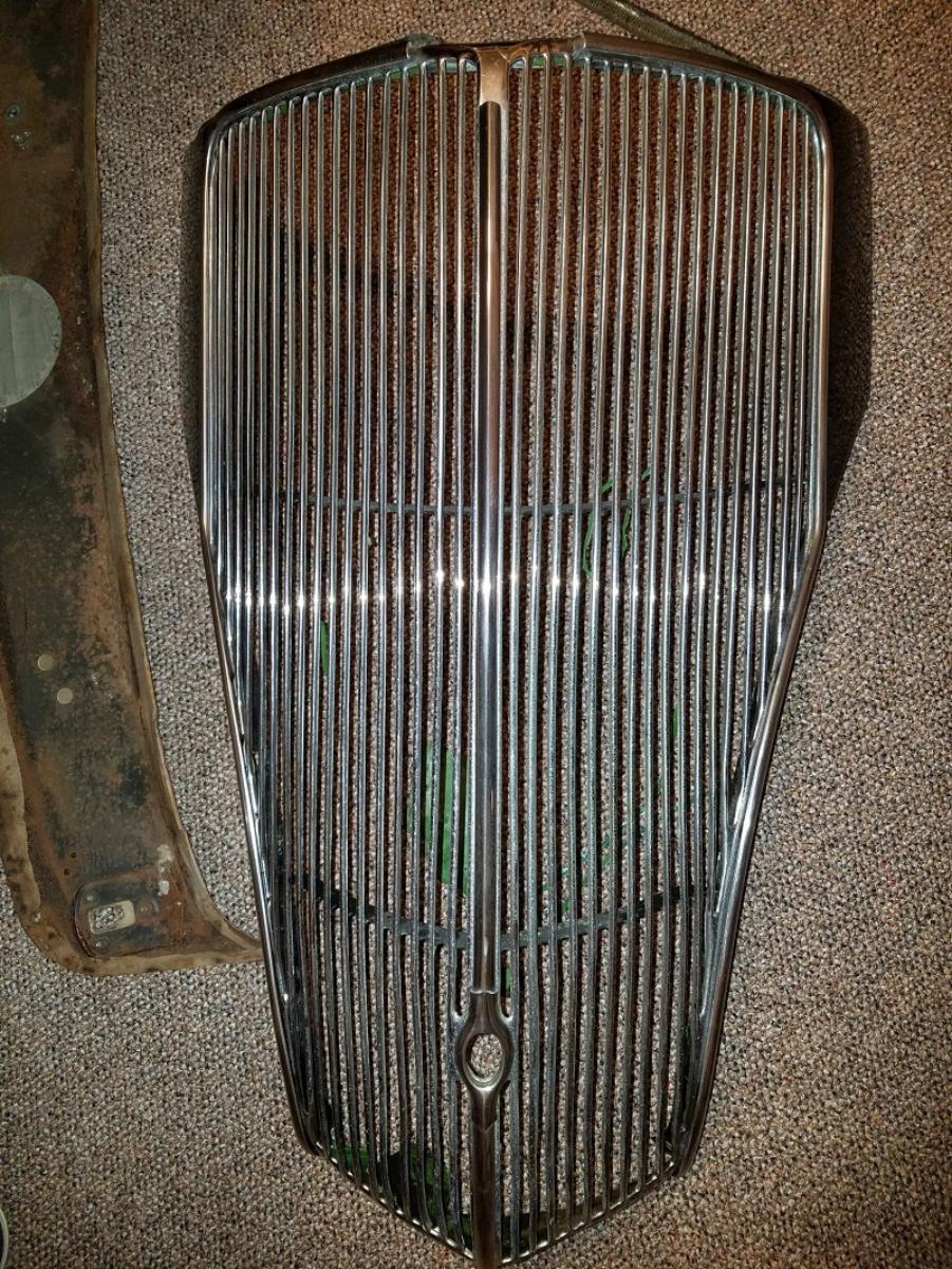

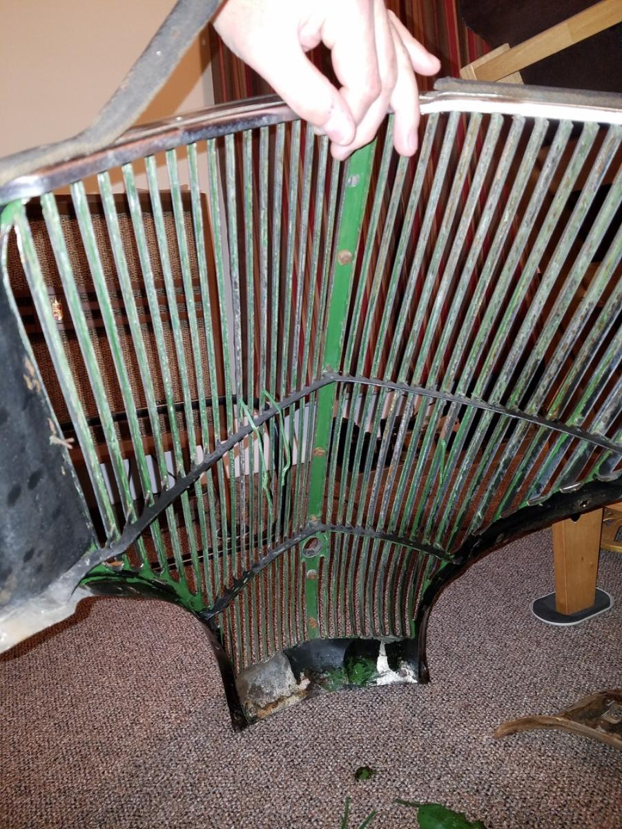

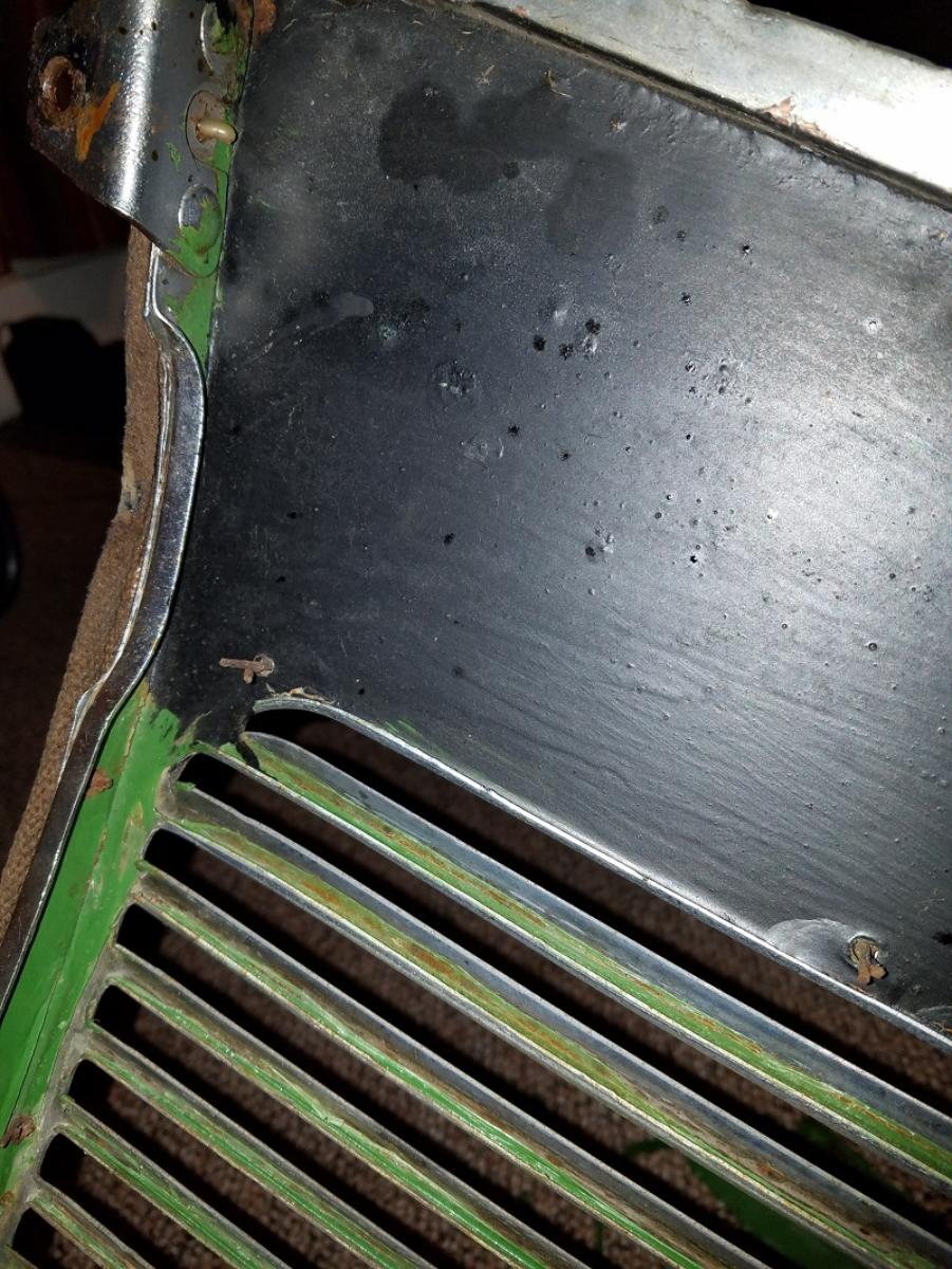

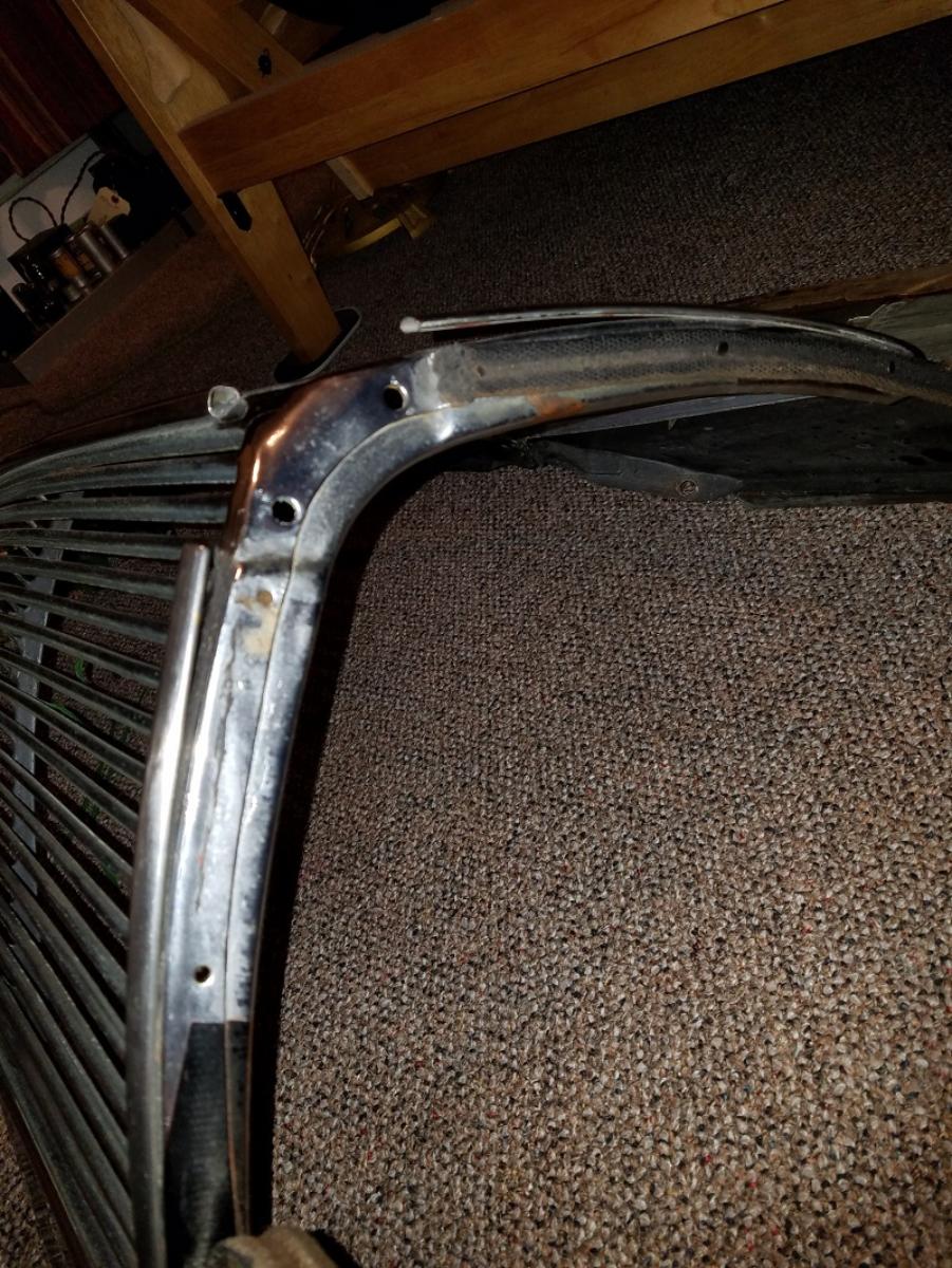

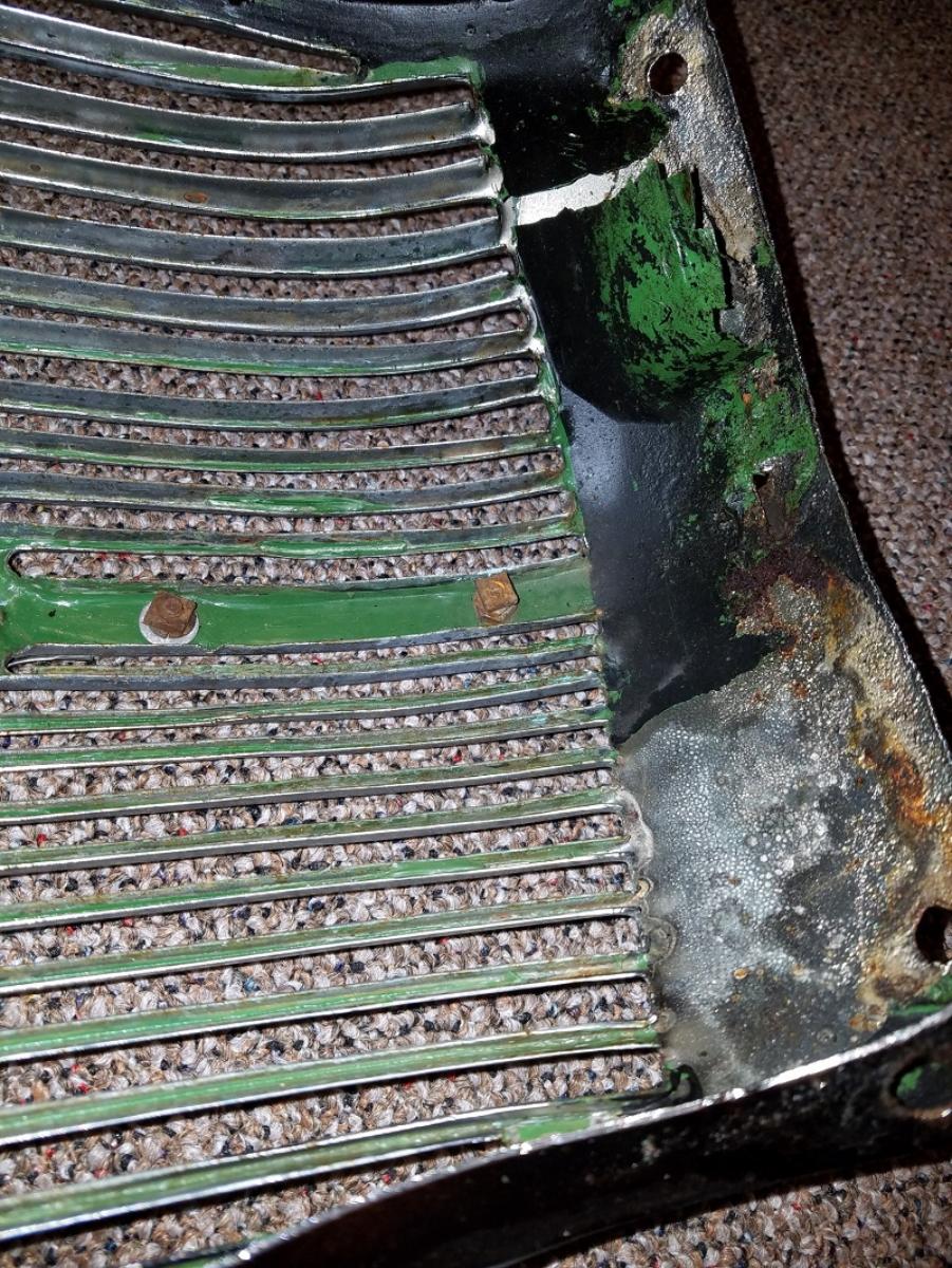

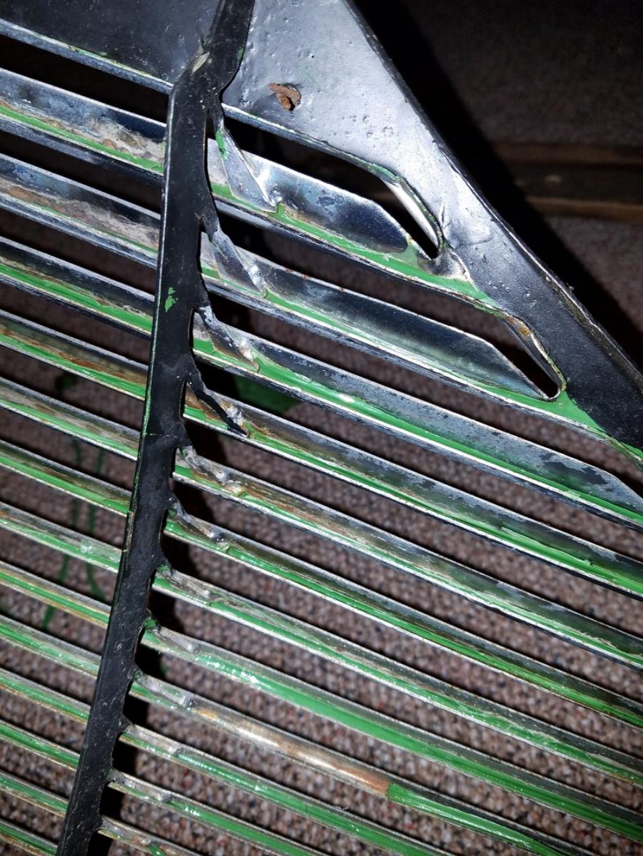

Question to pose to you all please. I have recently removed the radiator grille on my 1936 car as I start to take down the front end for service. I am having trouble figuring out if what I have is an original 1936 grille or a reproduction. Someone put some sort of green mold or tape that can be pulled off on the inside of the grille. Very sloppy job overall, I am planning to get this item re-chromed and wanted to make sure all of my ducks are in a row before investing.
What's your evaluation regarding please?

Several more pictures

It appears that this is an original 36 Ford one piece stamped grille. The green "tape" might have been a plastic type coating applied to the back side of the grille bars to possibly prevent rust. I would carefully remove all this material before sending to the plater. The bottom of the grille looks like it has some surface rust or rough finish. You should ask the plater if this grille should be first stripped of all old chrome and repaired before the plating is done. If you do not want to finish that surface, the plater can do it, but it will be part of the cost of plating, which now days if very high.

Yep, the real deal and being the one-piece stamping version, the best version to have re-plated.

The standard '36 Fords all came with a painted grille with stainless steel trim. Don't waste the money to have it chrome plated. If you do decide to have the grille chrome plated, keep in mind that an original chrome grille has a muted finish on the side portion of the bars, where-as the leading edges are bright chrome.
The sides of the grille, from the edge where the stainless trim goes to the hood panels were painted body color.

Reviewing the pix of your grille tells me that the work done on the grille was done by an unskilled repair person. Hard to say what the purpose of the green ?? was for.
The use of rusty bolts/fasteners to attach the stainless trim is also very suspect.

Thanks for your comments and pointers regarding the cosmetics of the radiator grille. I didn't realize the original chrome grille's had a muted finish on the side portions of the bars. As a matter of fact, this grille on my car currently has this very feature present.

Jon, It could be that your car has an original Ford chrome grille, which would not be correct for a Standard car. It could be that the car was in an accident some time in the past and the owner opted to replace the grille with a Ford chrome grille. There is nothing in the serial number and/or the body number to prove or disprove if the car is a Standard or Delux.
Or maybe a previous owner set out to decoy/clone the car into a Delux to enhance it's value.
