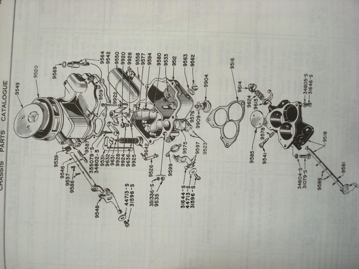

the photo should be for your carburetor part number 9642 is the pump. the leather may be worn, or broken ,or dried out?
it is a fairly easy fix, to replace the accelerator pump

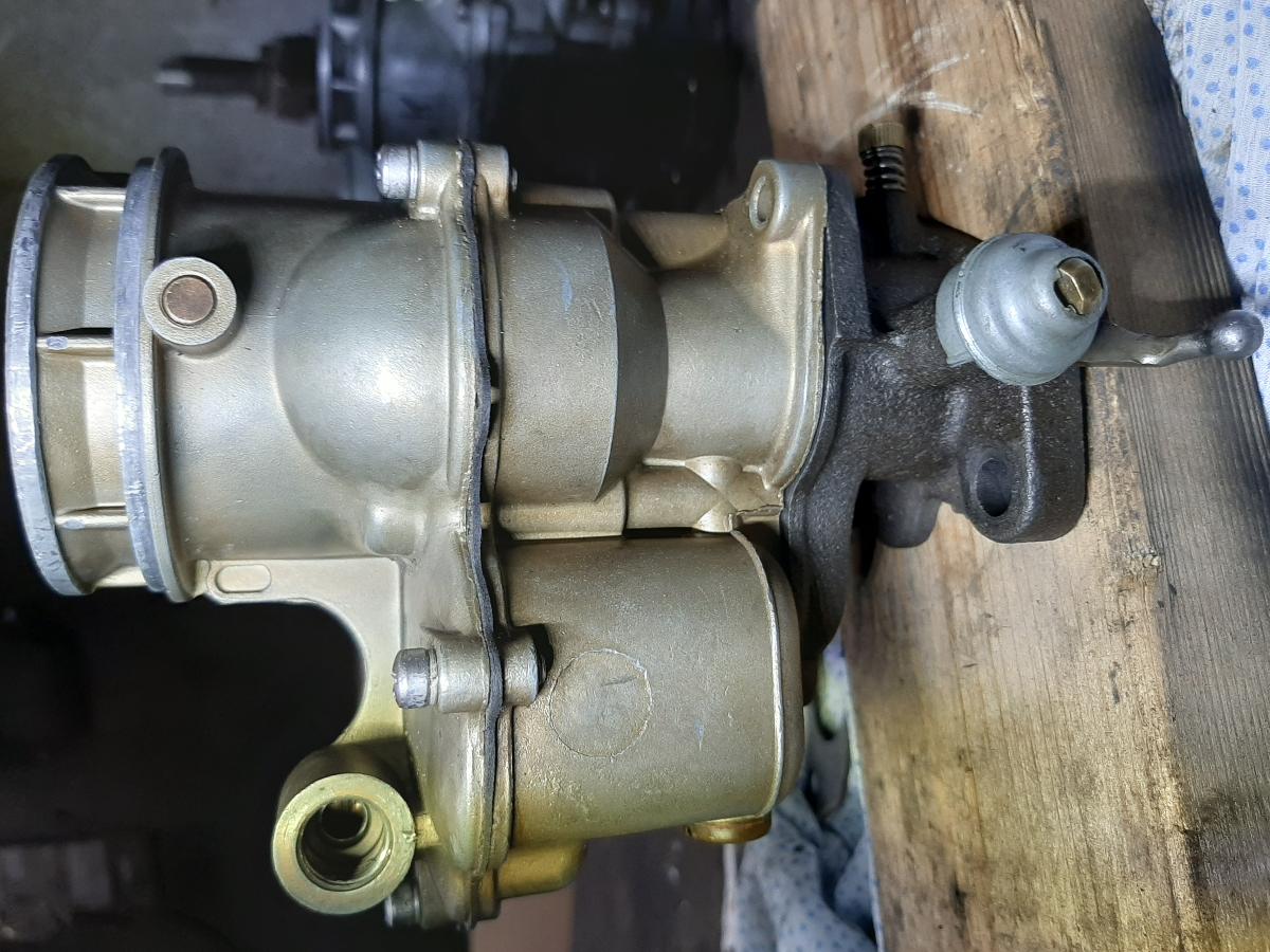

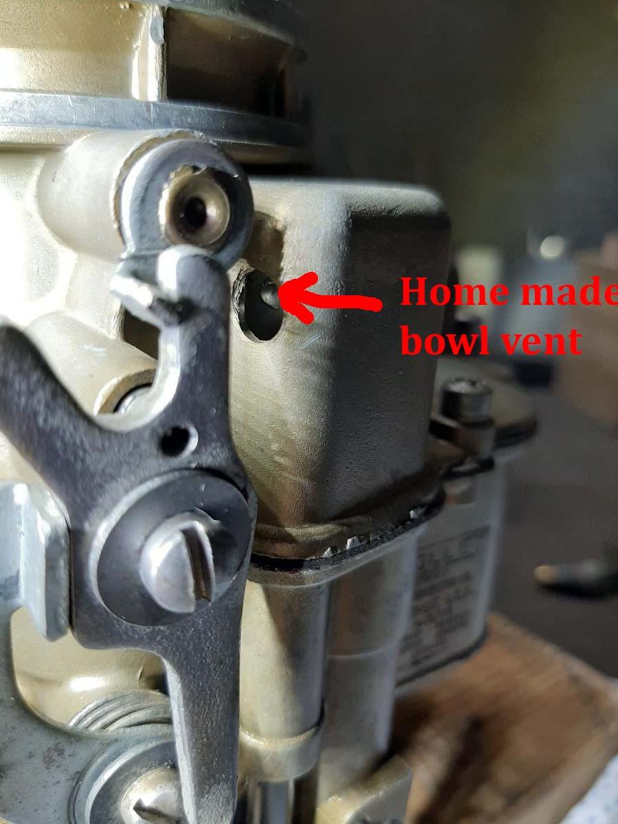

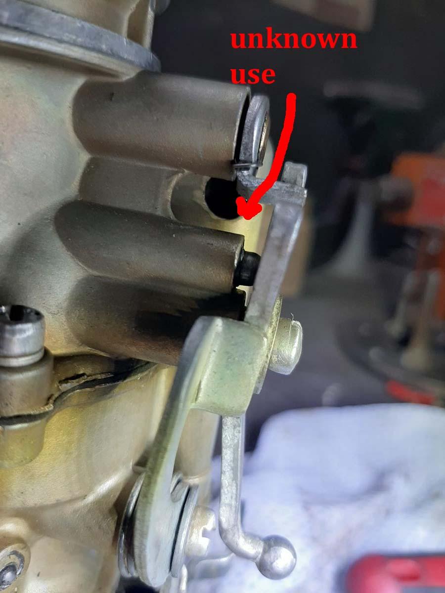

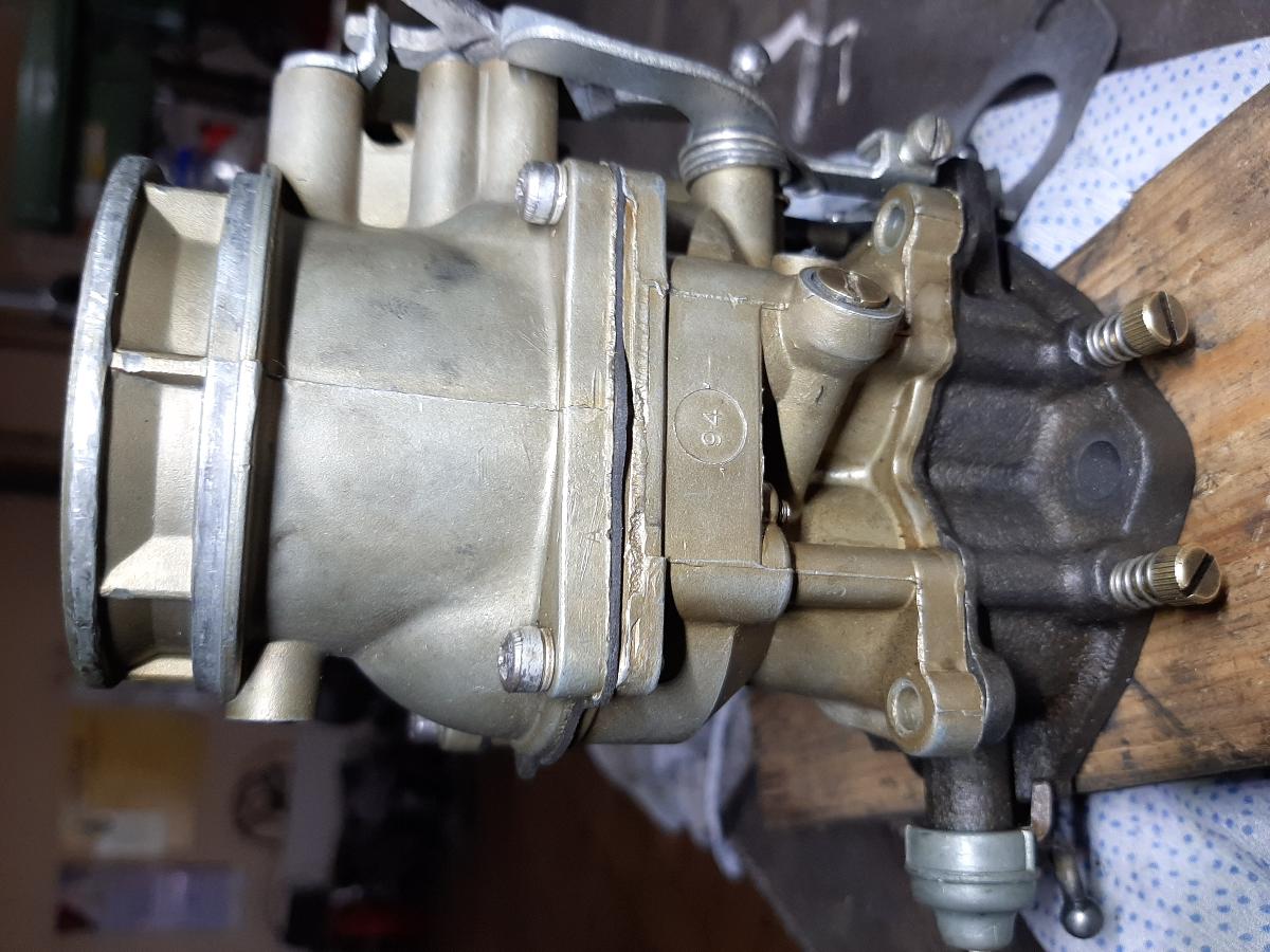

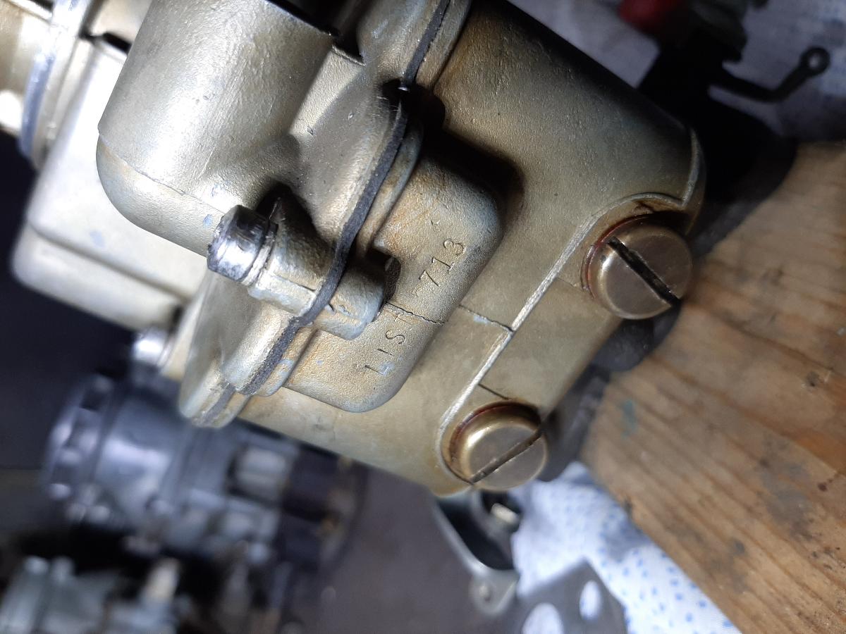

I currently have 3 holley 94 carburettors.
-an old loose one that was on the shelf. (the engine will not run properly on this one)
-an completely brand new one (the engine will not run properly on this one)
-a used one of a 40er v8. (with Ford logo)
(with this one he runs perfectly)
with 50 jets.
the new carburettor had 51 jets. So I thought I found the problem. Then I put 50 jets in here, unfortunately the problem was still not over.
the compression is between 70 and 110
the new carburettor is mine and the 40er is from someone else so can't leave it on the engine: D
This message was edited by durk on 10-14-20 @ 3:23 AM
