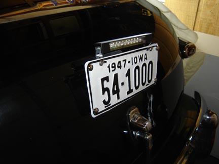

The only LED bulbs for old cars I have found are 12 volt type. Good suppliers, such as C&G, show halogen bulbs for your car, but most don't increase visibility to any extent. For my '47 I have installed a stoplight bar on top in the rear license plate. I put it on after my car was rear ended by a driver who claimed he didn't see the stop lights! Some improve the lighting by painting the inside of the light housing with silver or white paint. Be sure that the housing is well grounded. I run a separate wire to all light housings to provide a good ground. This alone can often improve performance. In this age, where modern vehicles have massive stop lights, our vintage cars need all the help we can give them!

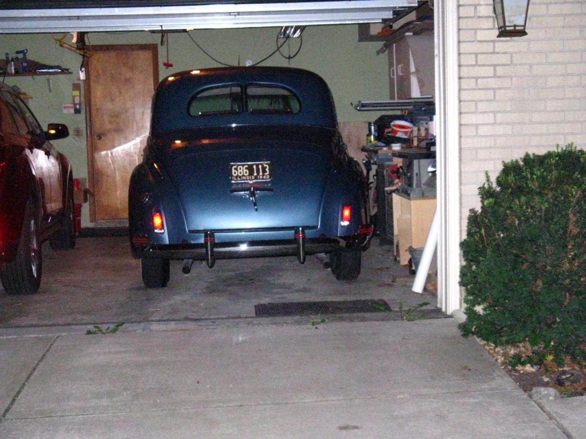

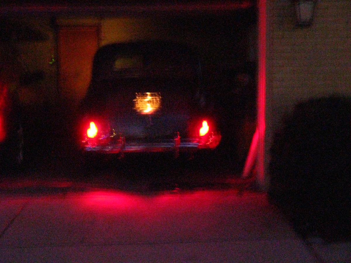

I enhanced my taillight brightness on my 40 Merc by using a flashlight reflector modified to fit in the housing around the bulb. That improved the brightness about 40%.
I ordered LED bulbs and installed them and I would say that the brightness improved 100%. I paid $25 a bulb, but I figured it was better than having someone run into me at night because they cannot see the lights.
I took some photos to show the difference, but they got lost with my phone. I'll try to get some more and post them.

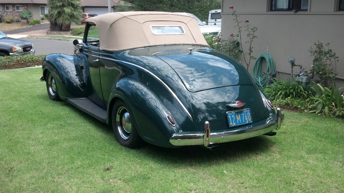

LED/Halogon bulbs in old car lights is not a good idea, both of which tend to be directional and therefore do not emit much light to the side of the unit, especially in the old style of tail light.
Paint the inside of the light body white, white is more reflective than silver and make sure the lights are well grounded. A little dialect grease in the receptacle also helps.
To increase visibility on the front and rear turn signals on my '39 conv coupe I had special LED lights made that we fitted into the bumper over-rides, red for the rear, amber for the front. The turn lights also work on the Hazard lights providing four-way flashers front and rear.
The modification is hardly noticeable when the lights are not on, when in operation the LED turn lights are very bright as are the original tear drop shaped tail lights.
When I get my '36 coupe back on the load, hopefully latter this year, I am going to use the same LED lights in the bumper overrides on the '36.
