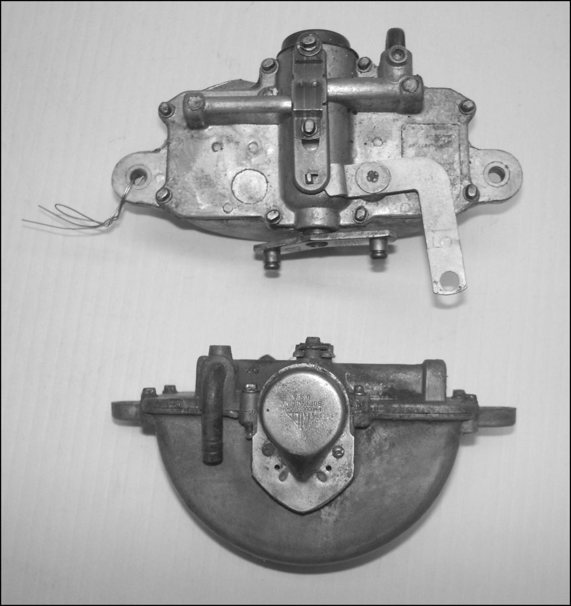

Hey Phillip, I saw you'd posted a wanted ad for a '40 convertible wiper control rod shortly after my earlier response to you. You state you "know it's different" than a coupe or sedan.
If you insist the rods are different, there is something amiss in your car. Wrong wiper motor? Wrong wiper control switch?
Hmmm... different rods? News to me and I am currently restoring my seventeenth '40 Ford.

Here are photos of the correct wiper motor and rod for your '40 convertible and for all the other '40 coupes and sedans out there...
