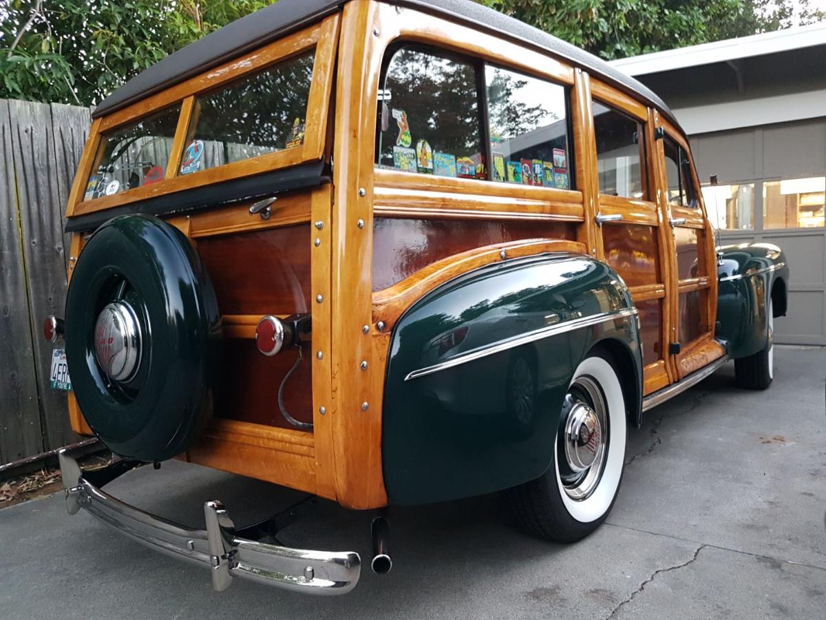

Jaques, one of the biggest factors is how often do you use your Station Wagon. I also used Epifanes varnish on my '46 "Woodie" and the varnish still looks pretty good after 55K miles on the clock. The car has been driven from NY to CA and has been in torrential rain for 3 days straight from Cleveland to Long Island. If you drive your car a lot, the varnish will eventually break down, but mine has been holding it's own for about 20 years.
