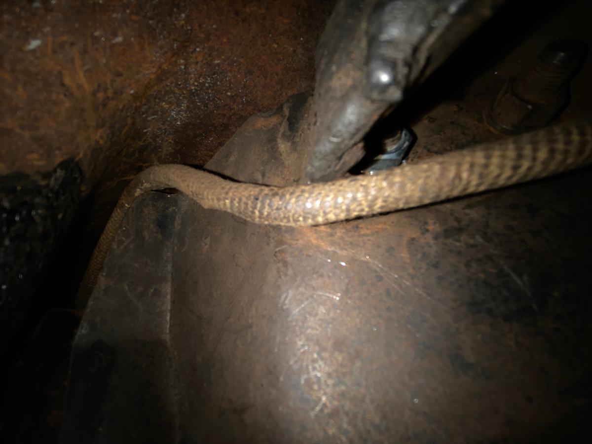

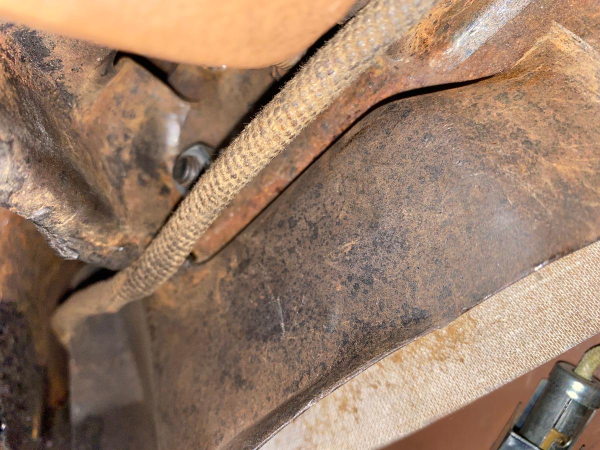

Thanks for the best wishes, Alan. FYI my radio is all one piece, including speaker. It is mounted in the center of the dash with the tuning dial at the bottom of the radio and the dash. It sounds as if this is different from yours
Has anyone put an antenna in a 38 Deluxe convertible sedan? These are the best I can get for pictures of the problem area. The old coax is what is pictured and it is stuck so the last bit (the antenna connector will not come out the bottom.
