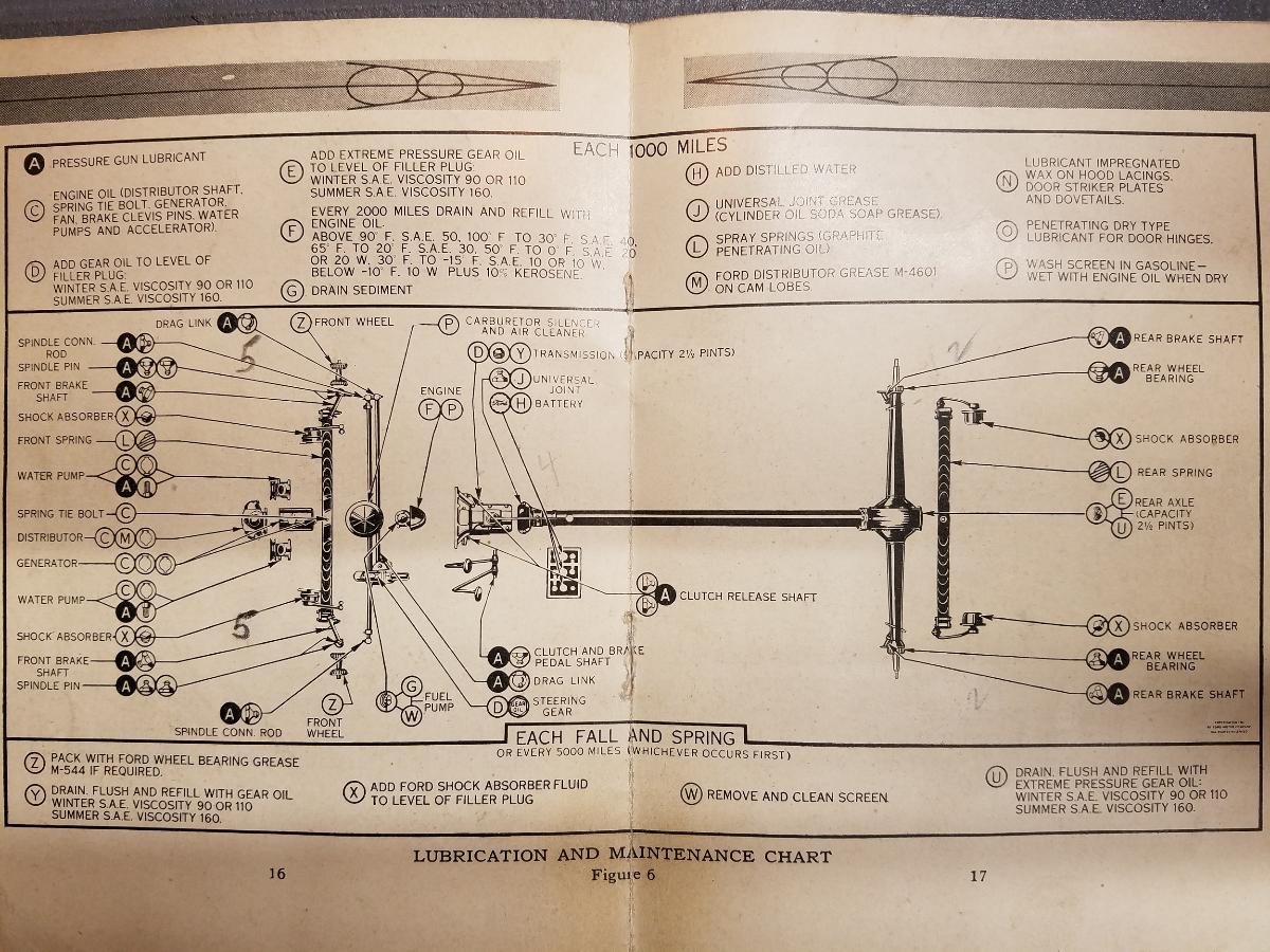

Jerry (voced),
You didn't say what year car you have so here is some information regarding gear oil.
600w oil was used in the Model A gearboxes to reduce the considerable leakage. For 1932 the requirements changed to accommodate the synchronizers and newer gear oils were specified from then on. Check your owners manual to see what is recommended for your car.
Some feel that 600W is actually more asphalt than oil. It is still sold by some suppliers as being for Fords up to 1948 (as indicated on the container), but it should not be used in a Ford after 1931. I suspect that marking the container as usable up to '48 is a "sales tool" to sell more product.
Ken
