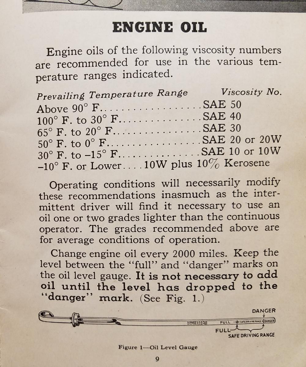

My 1936 car reference book states between an operating range of 100-30 F the viscosity number should be SAE40. I want to stick with stock lubricants and wanted to ask: What is the best brand SAE 40 on the market right now for these early V-8's? To my knowledge, my engine has never been rebuilt or taken apart.
Also, I would imagine this would be ND oil (non detergent) correct? Don't think they had detergent oil back then?
