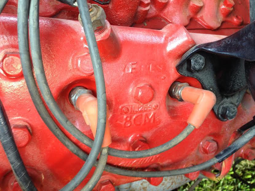

Gentlemen, I have a 1950 Ford Custom with a Mercury 8CM flathead V8 with an over drive transmission. It is a 6V positive ground electrical system. The Merc 8CM is not the original engine but it is very period correct. It has the standard cylinder heads, manifolds, Holley 94 carburetor just like an 8BA. My problem is this; the starter has locked up twice. Let me explain what happens. I will go to start the car and I hear the starter solenoid click and I hear the starter click (probably bendix spring engaging) and then nothing! The starter is locked up and won't release from the fly wheel. Very frustrating. The first time this happened I was able to remove the starter from the engine. I visually checked the starter and bendix spring and all looked fine. (I'm really not sure how the bendix spring works). Anyway, I thought it was a one-time anomaly so I reinstalled the starter and all worked fine. This was about 1 to 1-1/2 years ago. Now, as I was going to take a Sunday ride last Sunday, it happened again. This time it is really stuck. I attempted to rock the car in gear, nope. I removed the front lower pan to gain access to the fan belt pulley hoping I could turn the engine with a socket just a little bit, nope. So I attempted to remove the starter again like I did before. But this time, the starter is locked in there solid. It is not budging. I cannot remove the starter from the engine block. So I am stuck. Help! John
