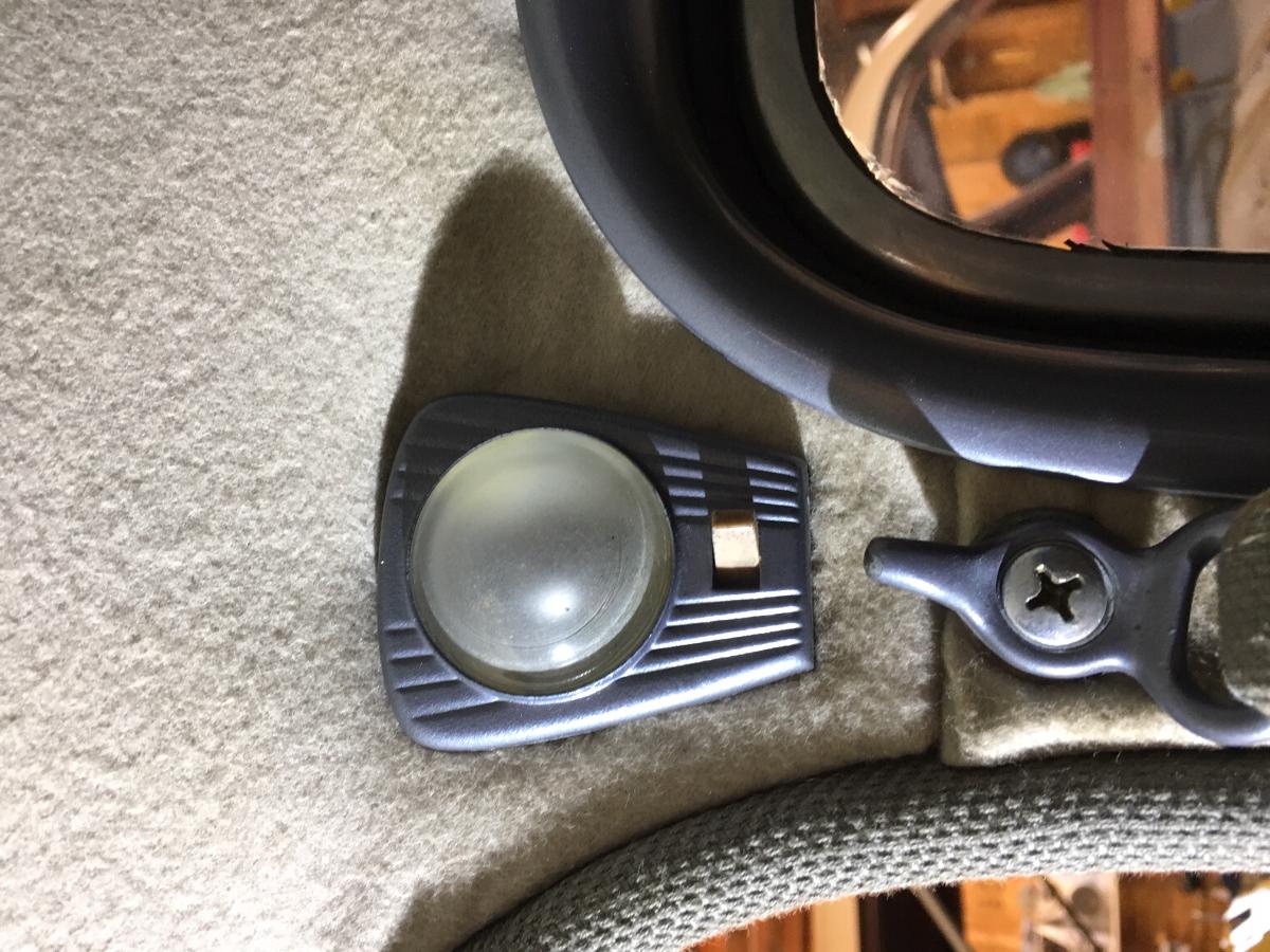

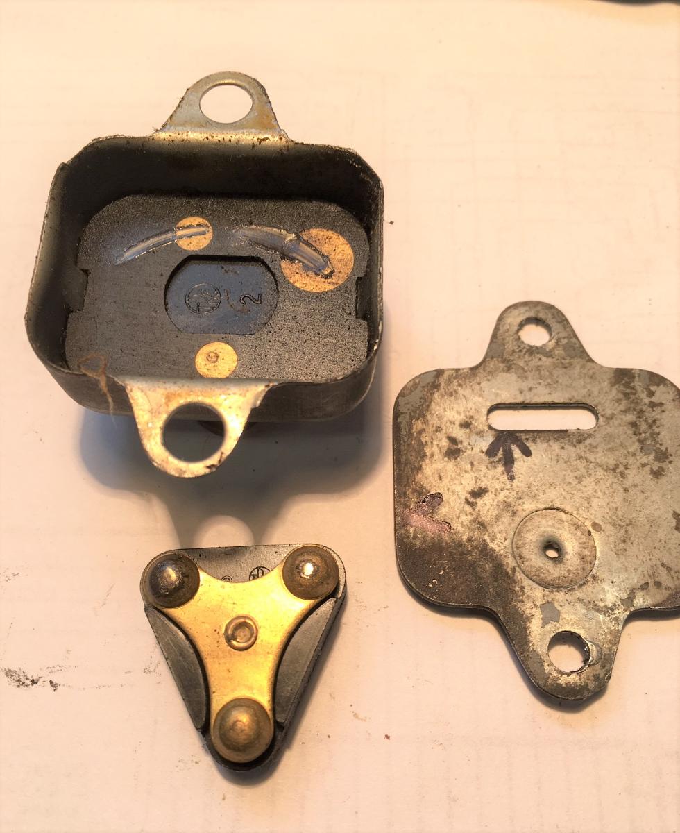

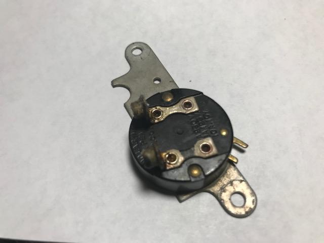

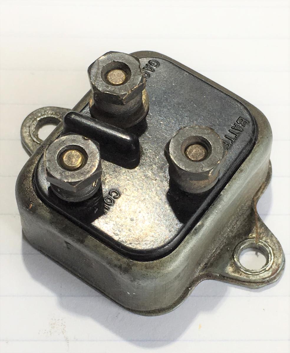

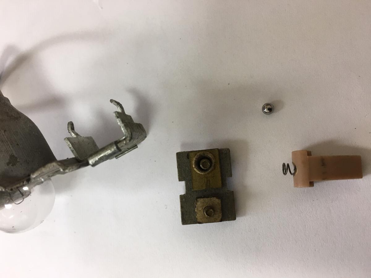

I am assuming that the switch is not working. In the picture, it looks like there are two brass pins that rivet the switch together. It may be possible to drill/grind the rivets to open up the switch, so you can clean the contacts inside. Reassembly can be done with small machine bolts/nuts, or you could make rivets out of some small brass rod, available at most hobby shops.
I repaired the ignition switch and interior courtesy light switch for my '46 Coupe by going through this process.
