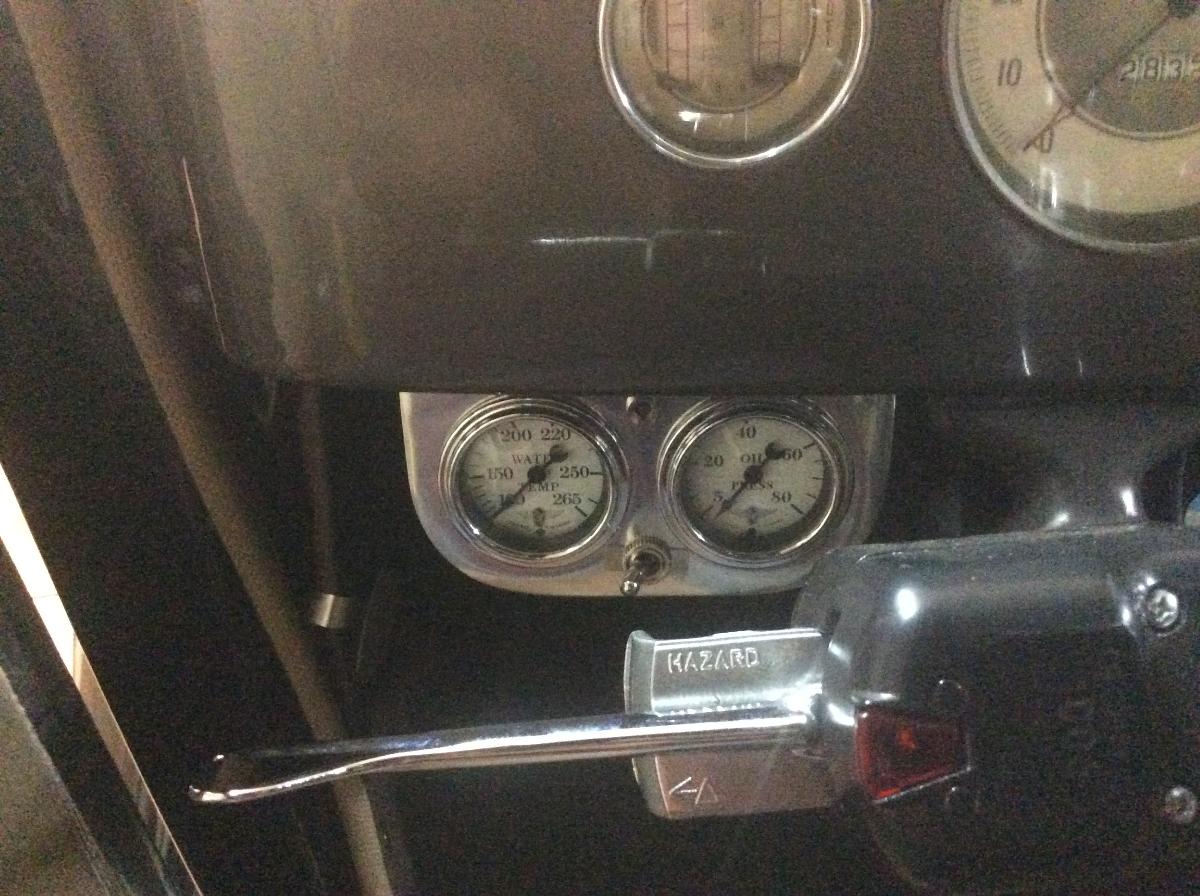

I installed the mechanical gauges in my ‘46 because the original gauges for oil and temperature were not working when I bought the car. I have since repaired the dash gauges, thanks to support from the members on this site.

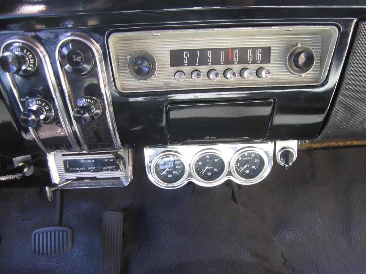

Here is a gauge panel mounted below the dash that includes three mechanical gauges. The water temperature gauge is to keep an eye on up to date changes in coolant temperature as the car climbs hills or encounters high ambient temperatures. The oil pressure gauge is to provide an accurate reading of oil pressure when the car is at idle after highway trips, when the original electrical gauge reads zero, I can be assured everything is OK as the mechanical gauge reads 20 PSI. The vacuum gauge shows how hard the engine is working and whether or not the power valve is open using more fuel.
