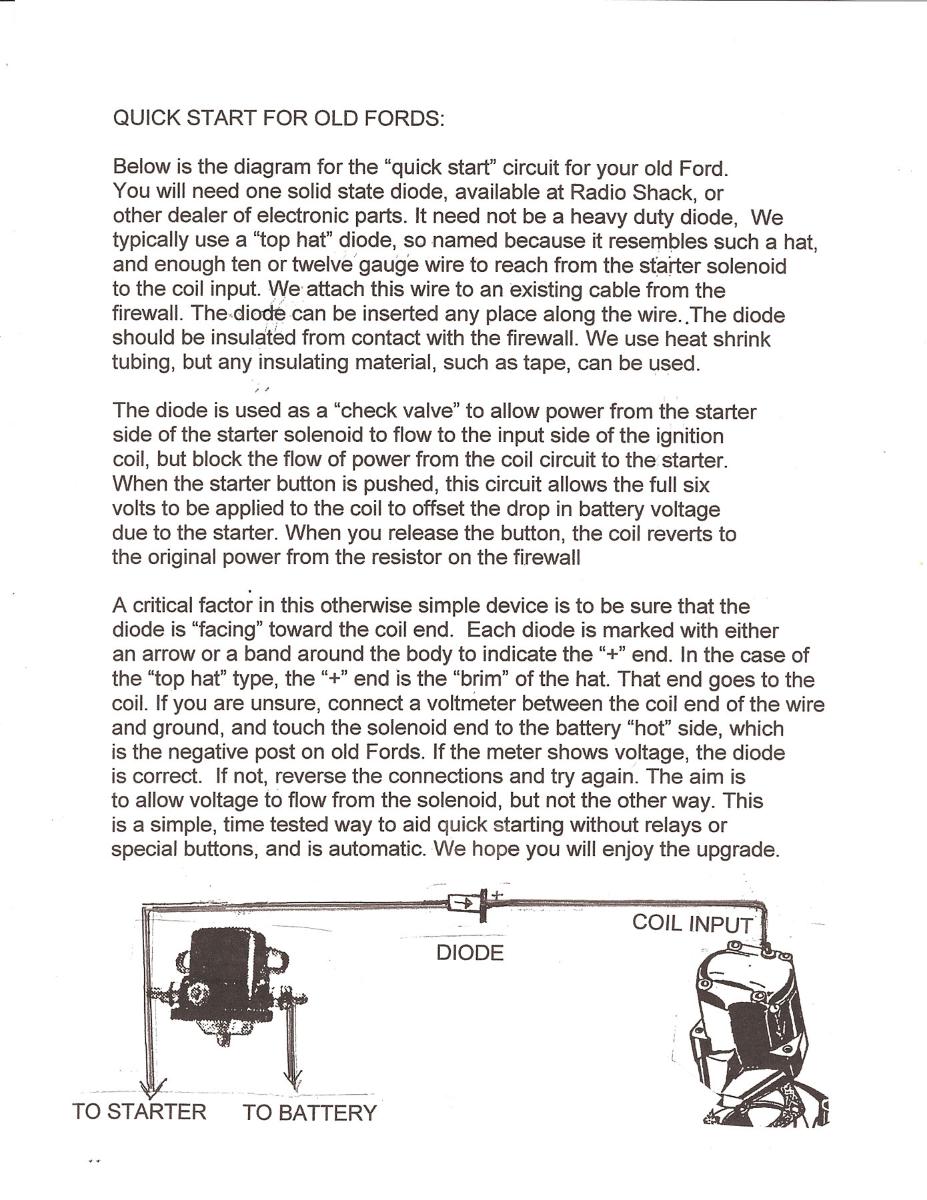

Thanks MG for posting my "quickstart" page. One thing to remember is that the circuit bypasses the ignition switch when activated, so disconnect one end of the circuit if you are planning to "bump" the engine during any under hood work. The engine will start and run as long as the start button is pushed. I posted the page years ago, and should have added this precaution at the time.

supereal's quick start for old Fords Attached below >

The diode bypass that superreal mentions is the only way to go. run a wire from the starter side of the solenoid through a diode to the batt side of the coil. Sure saves wear and tear on the starter. I use one that is intended to replace the innards on an early ford generator cutout.

If, the starter gets hot from exposure to the exhaust manifold, it will lose power due to high resistance in the windings. Worn bushings will allow the armature to drag from contact with the pole shoes, as well. I use a diode booster on my'47 and other cars. If interested I will post the instructions again. Modern cars used to bypass ignition resistors to increase ignition power to aid starting by compensating for voltage drop.
