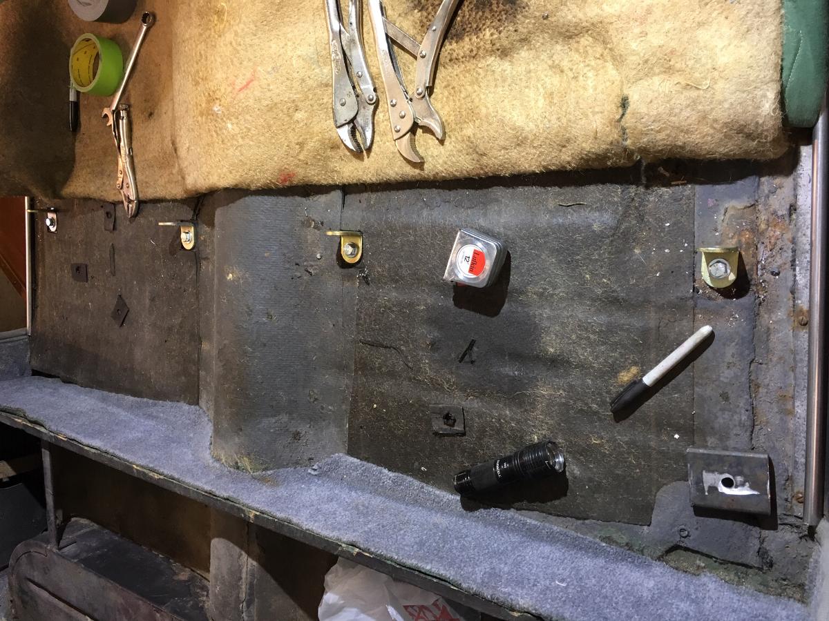

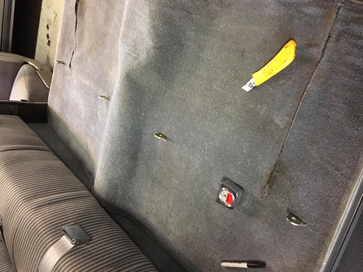

I did some under dash work on my 46, at the same time I was changing my master cylinder. As the brake pedal was to the floor, it gave me the idea to tie the clutch in the release position to get it out of the way for more head room, and I removed the front seat. That gave me good access to do the under dash thing. At my age, it would have been painful to work any other way. While I had the seat out, I decided it was also a good time to install seatbelts front and back.

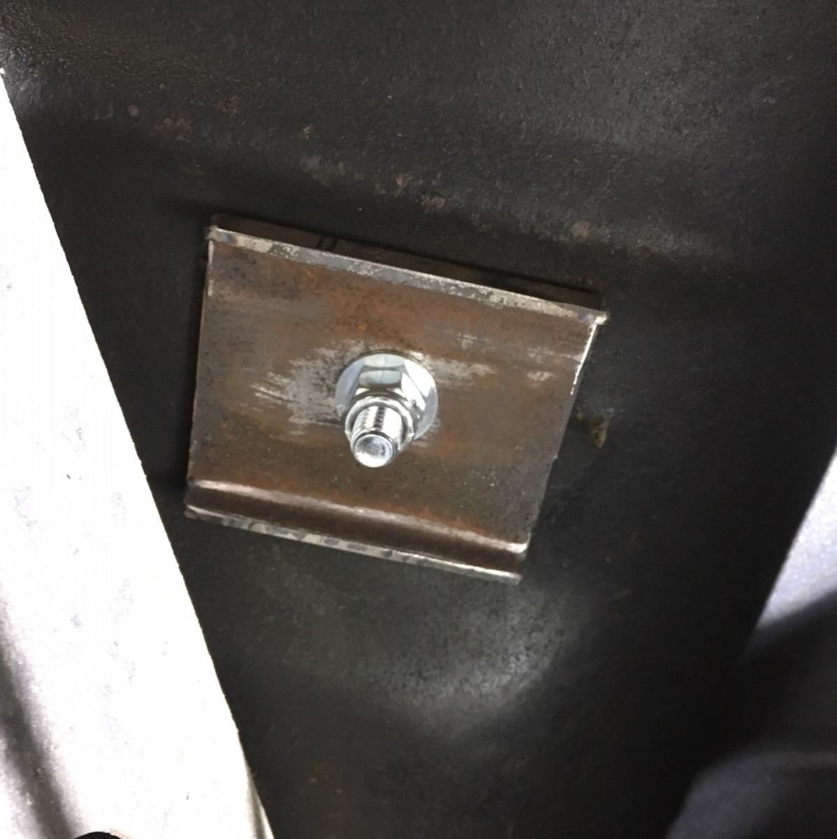

I hope those clips you cut into the floor either are bolted to the frame under the floor or have some sort of reinforcing plates under the floor. If that hasn't been done, if you ever stop suddenly they will pull right through the floor.
51woodie
06-29-2020 @ 5:58 AM
