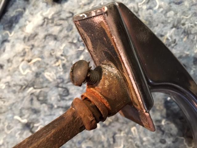

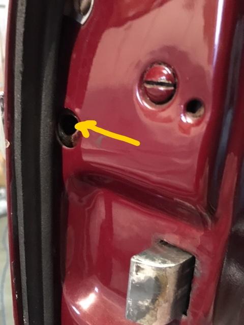

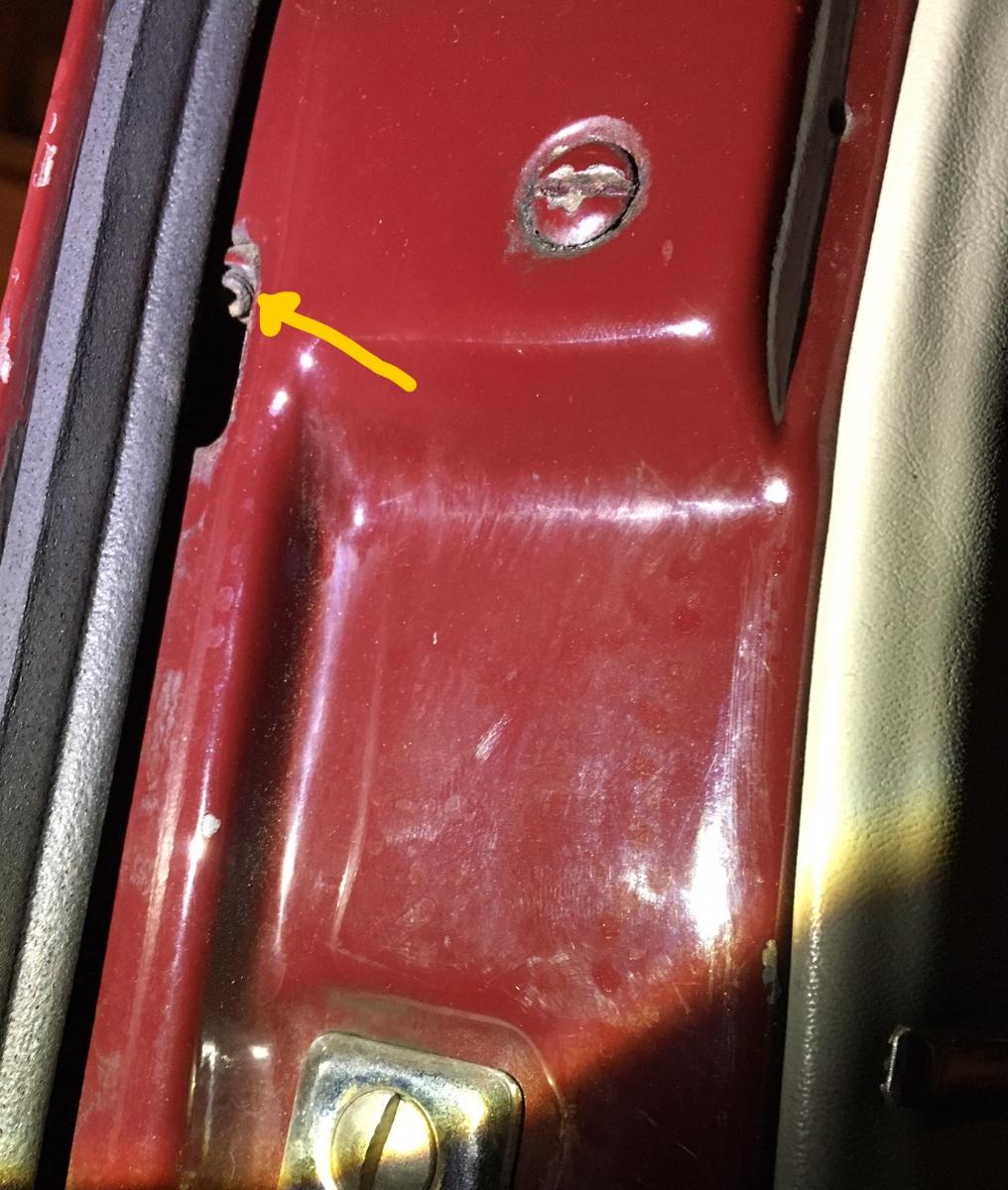

I would suggest you pull both door locks to see if they are the same code. (The door and ignition key should be the same.) If the door lock codes are the same, then the problem is with the one lock. Possibly seized, so try penetrating oil and wiggle/jiggle key in the lock. If the codes are different, then contact one of the Ford lock gurus on this site, and they can help. Not hard to remove the locks. There is a "set screw" on the back end of the door at the same height as the lock. They are sometimes hidden behind the door weather seal. There is one screw for the door handle as well, that is above the screw for the lock. (see pics) My set screws were Allen socket, which are not original. I believe the originals were slotted.
