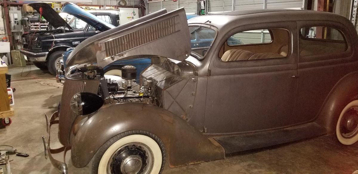

Please post pictures, always fun to see a true survivor.

I have the drums off front and rear. I have gotten the drums cleaned up in the parts washer, and ordered new shoe linings. That's why I was asking about seals and what else I should be doing. I've had a couple people reach out to me offering help, that's what is do great about this forum.
I'll try to post a couple pics, I couldn't get them to upload....
forJJ
06-14-2020 @ 6:31 PM
Posts: 44
Joined: Mar 2015
In my shop this winter
