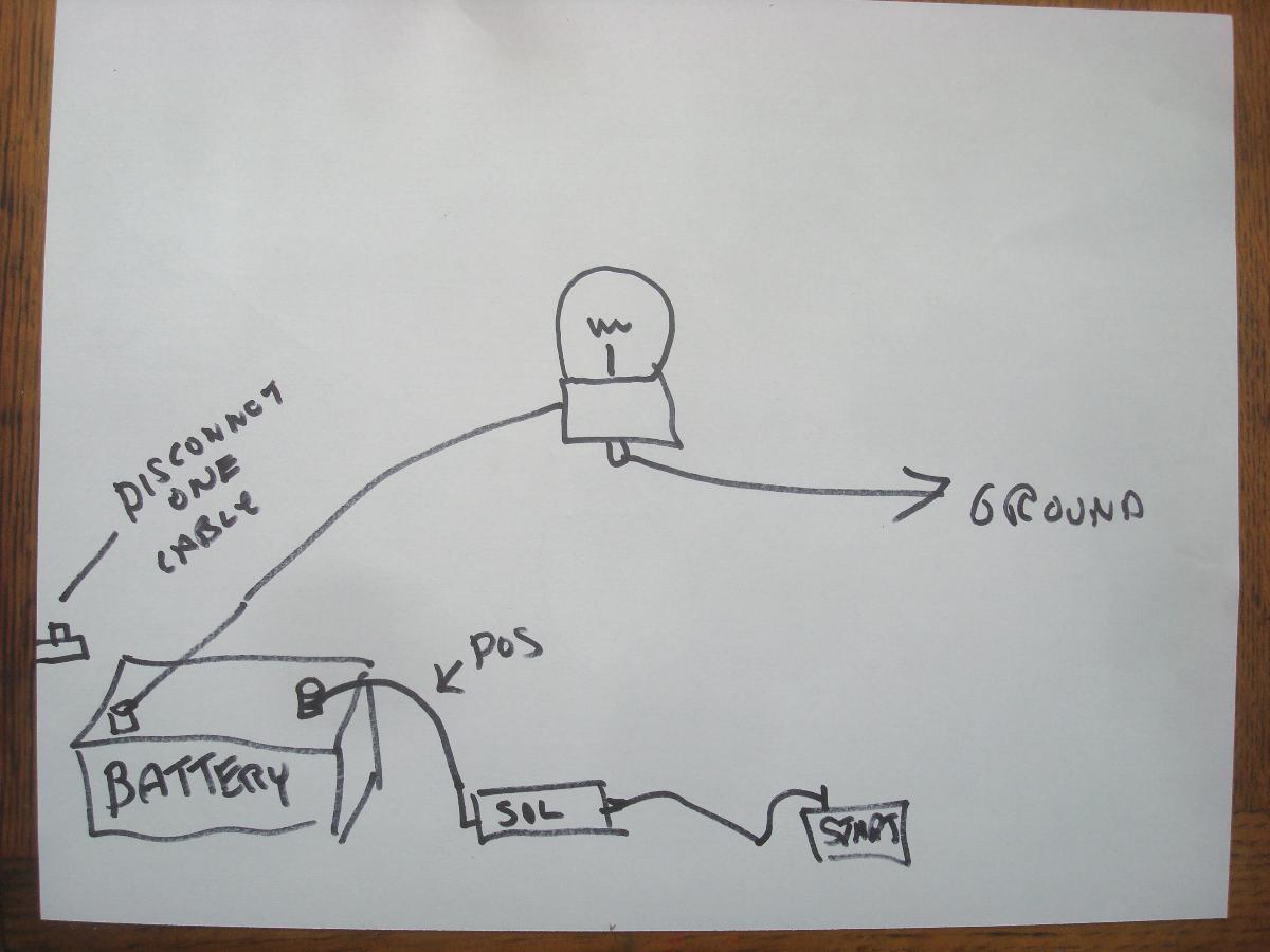

06-08-2020 @ 6:03 AM
hi silverechief
battery always dead,,,,
here a simple way to check for battery draw, nothing fancy, but will do the job,
you can easily build a simple tester with a 6 volt bulb, 2 wires 16 gauge and 2 alligator clips, and a soldering gun,,
the brighter the bulb lights the heavier the draw,
you keep disconnecting things , like starter, generator,stop light switch, regulator dome light etc,
Till the LIGHT GOES out, when it goes out you found your problem,
hope this may solve your problem 1937Ragtopman Lets hear how you made out,
