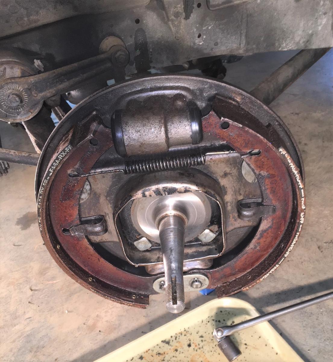

Thanks 51 Woodie, Is the attached picture a 39 or 40? just wondering and trying the learn the differences. My 40 has different mid shoe retaining clips. Mine are more shallow and are squared off not gently folded, longer finger shown in your pic. Second difference is on mine there are no cotter pins in the lower set of anchor pins ( the ones with the bronze cams on them). Just curious?? My name is actually Josh but the car came from a fella named Don Durkee in Thousand Oaks CA and the plate was "Dons40" Sadly, I don't believe Don is with us any longer, nice Guy..
51woodie |
06-03-2020 @ 6:21 PM
My apologies Josh. The picture is of the front left wheel spindle on my ‘46 Super Deluxe.
