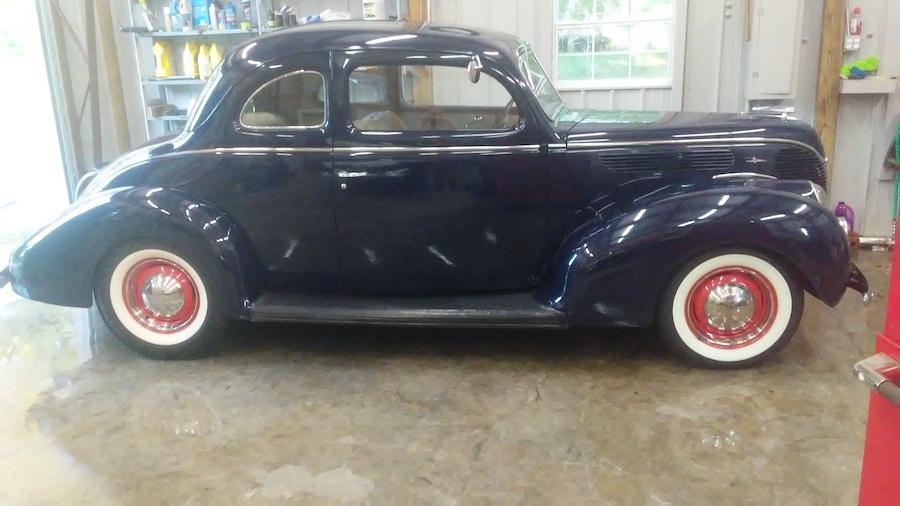

40cpe
05-26-2020 @ 6:38 AM
Posts: 488
here is a '38 version of the club coupe:
05-26-2020 @ 6:40 AM
Posts: 4351
You have a '37 club coupe. That body style was '37 and '38 only. Chassis is the same as all '37 passenger cars. The main difference is the roof is longer and a little higher than a regular coupe. It does in fact have a full back seat and the quarter windows do tip out for ventilation. They came in the deluxe model only. I have owned both a '37 and '38 club coupes. Production was fairly low in both years of that body style. Purchase the V-8 Club's 1937 book and it will be listed in there.
