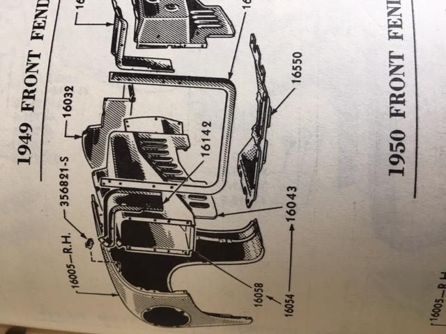

Overdrive. The hood on a '50 curls down at the front, and the release latch is above and back from where the release cable attaches. I think your only access may be to remove the splash pan #16550, which, if my thinking is right, should give you access to the front side of the rad, and hopefully to te latch mechanism as well. I don't know why the pic is sideways. Rotate 90 deg. clockwise and it is easier to read.

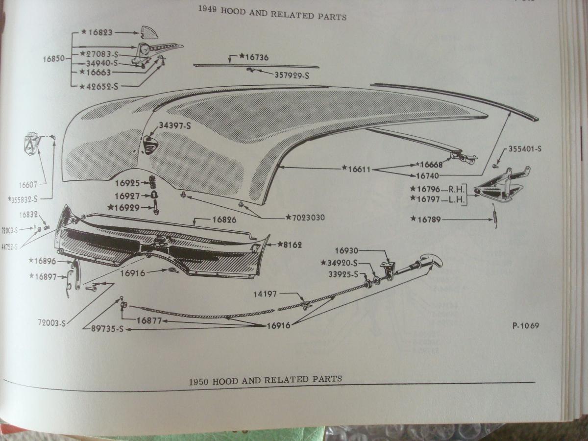

05-05-2020 @ 11:41 AM
hi overdrive
I had a 1951 what
I used to use a long strong screwdrive or a thin pry bar and slide in the hood crack and try moving the lever to the drivers side, this should do the job.
I POSTED a PHOTO of the 1950 FORD hood parts,
this may help you
I have this book that I took the photo from for sale, but now decided to keep it, covers 1949 to 1959
it is very handy, for researching
let HEAR how you made out, 37 Ragtopman

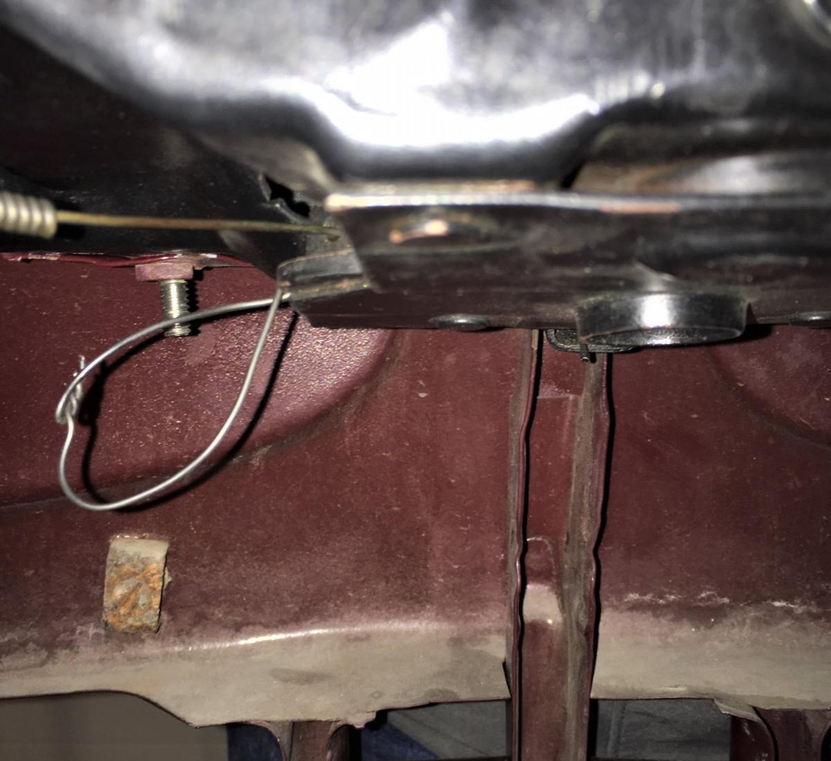

After reading a similar post several years ago I ran a second cable from under my dash to the hood release on my 46 coupe. Now I sleep better.
51woodie
05-06-2020 @ 4:47 AM
I think I read the same post as silverchief, so I connected a wire loop on the hood release of my '46 coupe, that I can get at from under the car, to release the latch with a piece of wood dowel if the cable breaks. I also removed the inner wire, as the hood release was really hard to pull. Cleaned off the rust, oiled and installed, and now very free to operate. The most likely place for a cable to break, is where the lock collar is clamped on the end of the wire. I had enough slack in the wire that I could place the collar on a "fresh" piece of wire.
