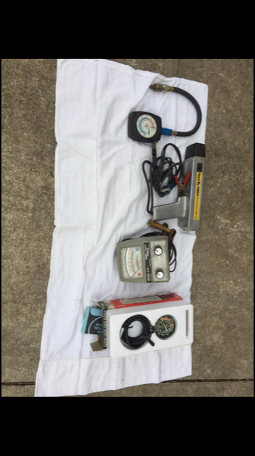

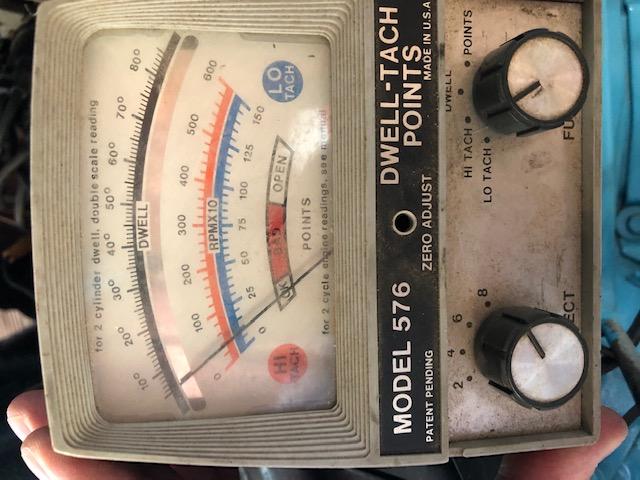

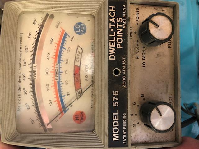

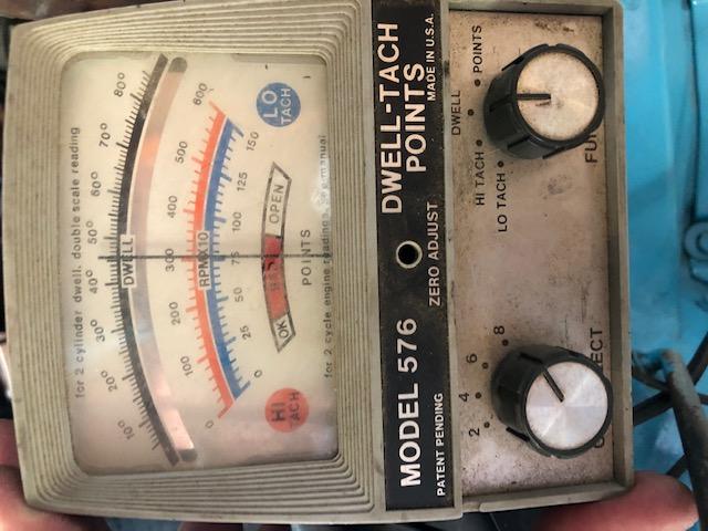

I found a collection of used diagnostic tools. For $30, thought they might be worth it. Disconnected vacuum advance. Hooked the dwell meter up and it read 44. My book said dwell for broken in points should be 58 to 63. I tried tightening gap to increase dwell., but couldn’t get it above 44. I bought and installed new points at Napa. Gapped at 15, and got dwell up to 46. Car seems to be running fine. I adjusted the carb settings slightly. I’m not sure if tester is accurate? Posted the results of each test. I hooked the black and red leads up to battery and yellow lead to negative side of coil. Calling it good for now. Open for suggestions as always.

My guess is that the dwell meter needs calibration or could be a 12volt only meter. I am sure that your idle RPM is more than 160RPM.
