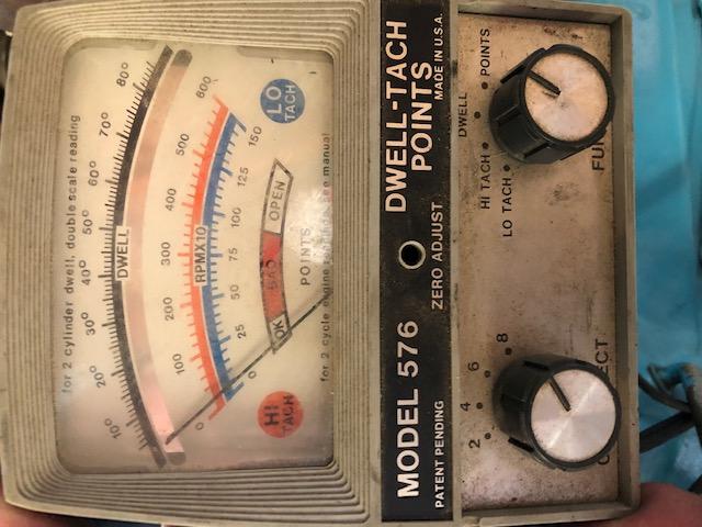

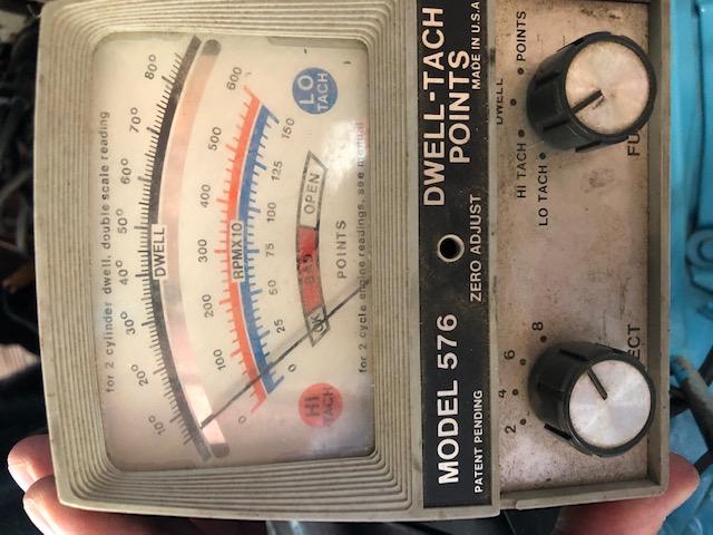

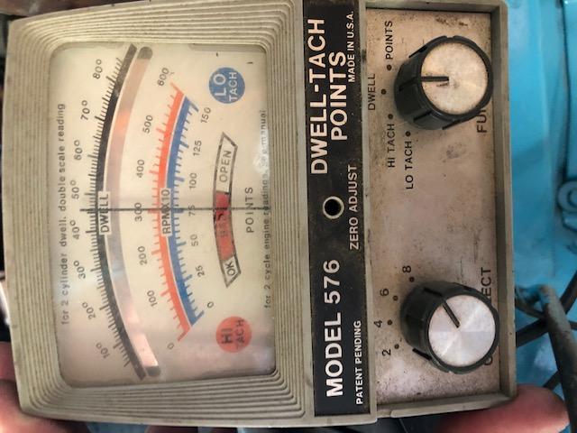

Update - first, believe my acceleration issue was loose wires at the distributor cap. I reworked the ends and got them to tighten up. Test ran and acceleration was fine.
I found a collection of used diagnostic tools. For $30, thought they might be worth it. Disconnected vacuum advance. Hooked the dwell meter up and it read 44. My book said dwell for broken in points should be 58 to 63. I tried tightening gap to increase dwell., but couldn’t get it above 44. I bought and installed new points at Napa. Gapped at 15, and got dwell up to 46. Car seems to be running nice. I adjusted the carb settings slightly. I’m not sure if tester is accurate? Posted the results of each test. I hooked the black and red leads up to battery and yellow lead to negative side of coil. Calling it good for now. Open for suggestions as always.

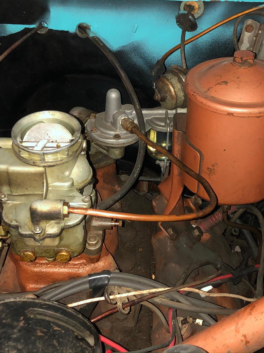

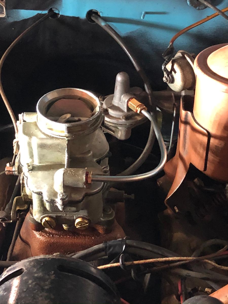

Took it out for a drive today. No fuel leaks....but getting some hesitation in 1st and 2nd on acceleration; ran fine in 3rd. Along with the fuel line, I adjusted the point gap, gapped spark plugs, adjusted carb. I broke my “one fix/adjustment at a time” rule.

Those fittings with a 1/8" PT male end and female 1/2X20 ford nut thread are very hard to find item. Don't lose it. Glad it worked out for you. ken ct. I have restored FP's with the both holes 1/2X20 thread which would eliminate the extra fitting.if you ever want a spare one. 1-203-260-9780 cell
