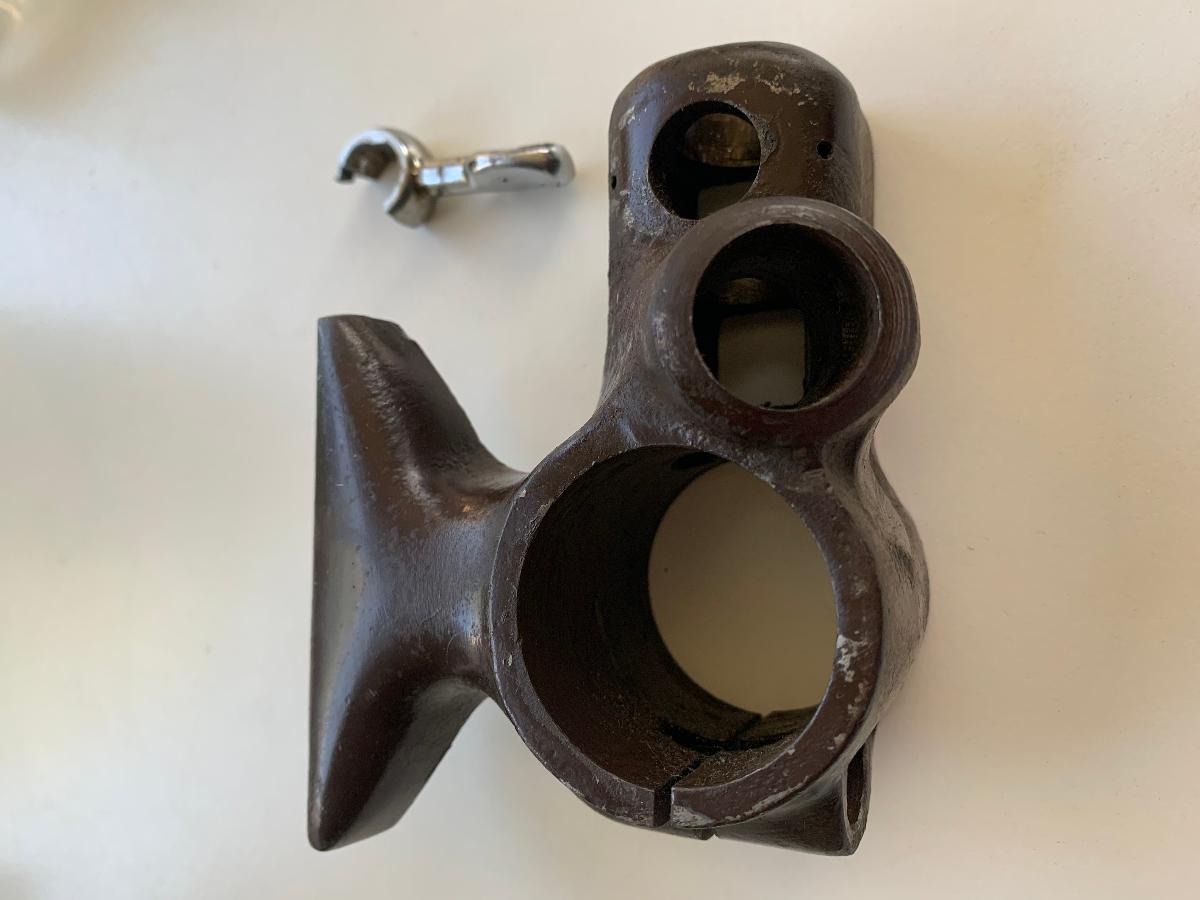

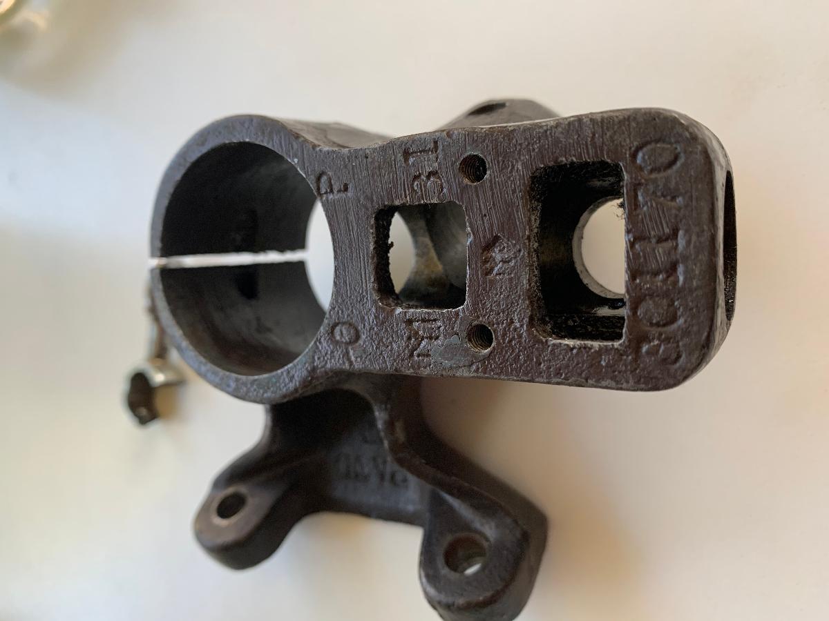

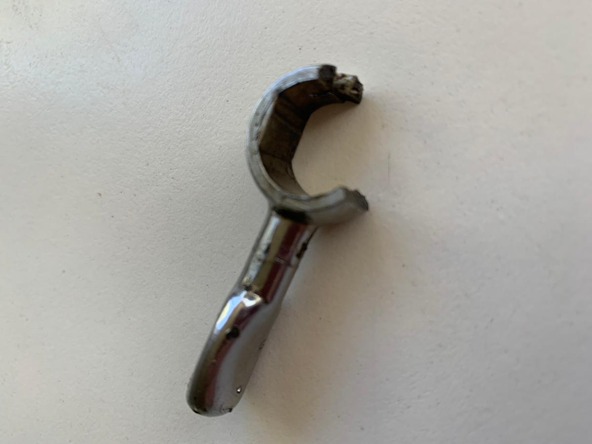

I am trying to repair this column drop for a 1936 Pickup. Any idea where I can find a on/off switch lever and a lock cylinder that will work?
The cast column drop is stamped "301170". See photos.
My goal is to make it work. It does not have to be 100% correct.

Here is an exploded view (by Gary Tosel) showing all the components in a 35/36 column drop. I think that you may need a few more parts than you mentioned.
04-20-2020 @ 5:00 AM
Posts: 1801
You should try Third Gen Auto I know he sells the 32 and early 35 style bulls eye switch. Don't forget the often lost item 12 from the post above. Third Gen also has these.

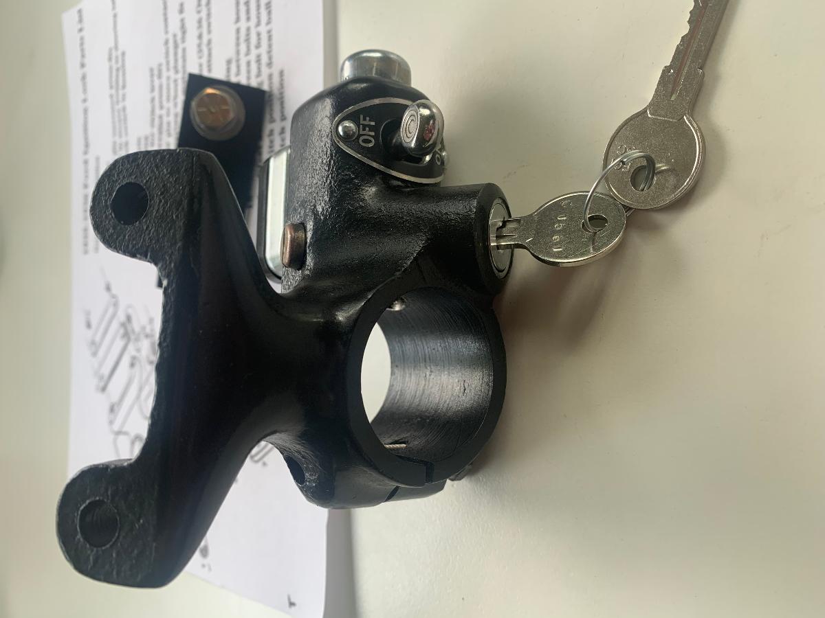

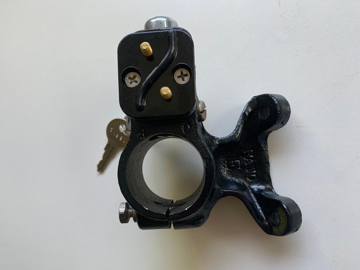

I think I got it. It took me awhile to figure out the mechanics of the ignition switch assembly. Especially that the bent tab on the switch plate inserts into on-off lever grove on the bottom to keep it from sliding with plunger. Lots of moving parts in the housing.
