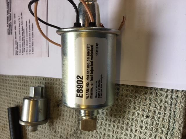

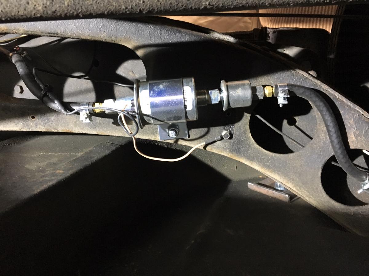

Chip. I'm not sure which "new one" you refer to, but Summit has E8902 pumps available as per the link below. This is the pump I use for "priming" my stock '46 Super Deluxe and it works for me. Note: for some reason the picture of the pump mounted on the frame rail downloaded upside down. The filter is actually on the tank end of the pump.
https://www.summitracing.com/parts/atx-e8902
