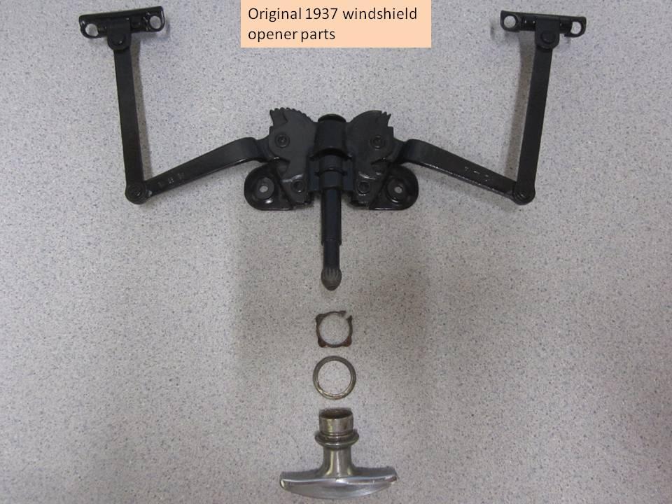

I have done this several times on my 37's. I crawled up under the dash and used a small screwdriver to pry open the locking washer. The attached file illustrates the regulator, handle and washer.

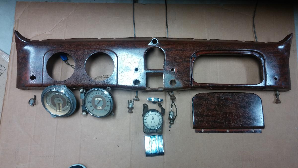

I was able to remove the dash yesterday. Gregg, again thank you for the tips. Hopefully I remember how it all goes back together!
